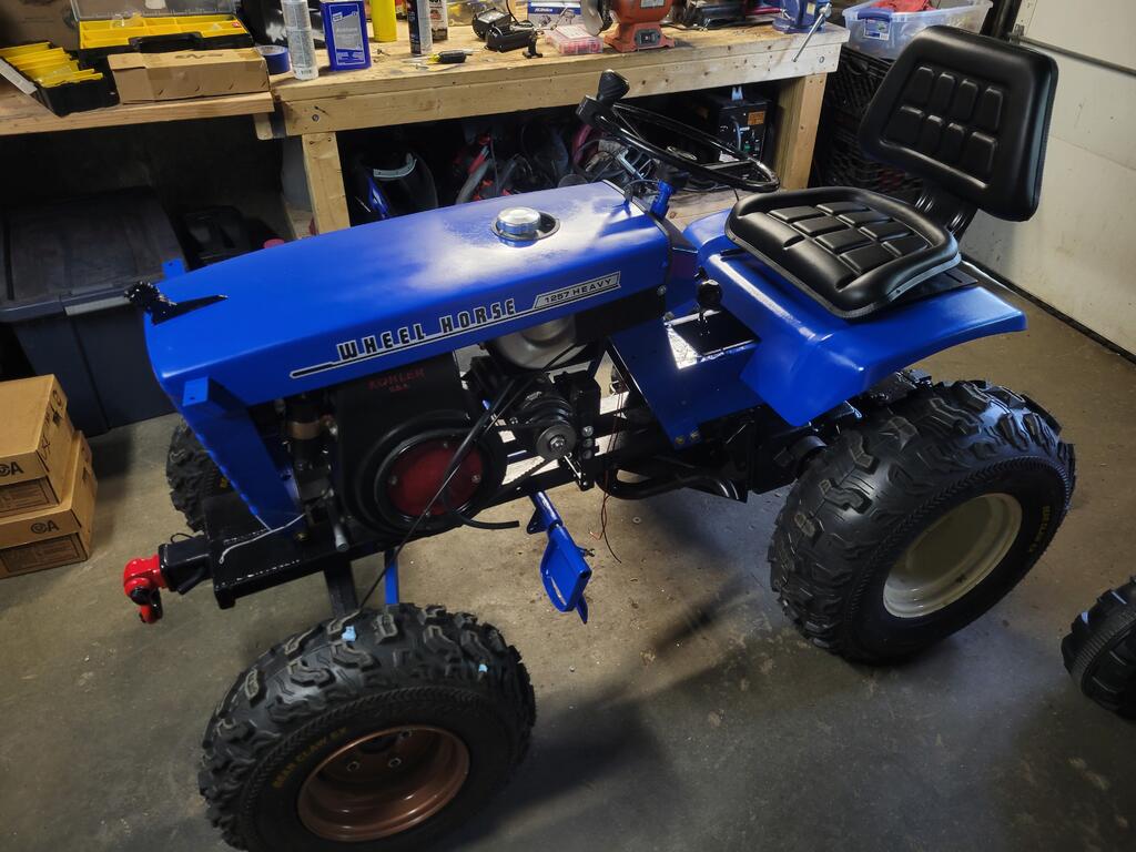

ebinmaine 74,531 #3 Posted May 22, 2021 The clutch pedal is connected to the pivot that goes through the frame by a rod. You won't need to modify any linkage because your height modification is behind the frame. Your clutch is connected in a very similar manner to Ariel's tractor. I can get pics of the carb linkage tomorrow. That's a little more complicated and pics should be helpful. 1 Share this post Link to post Share on other sites
