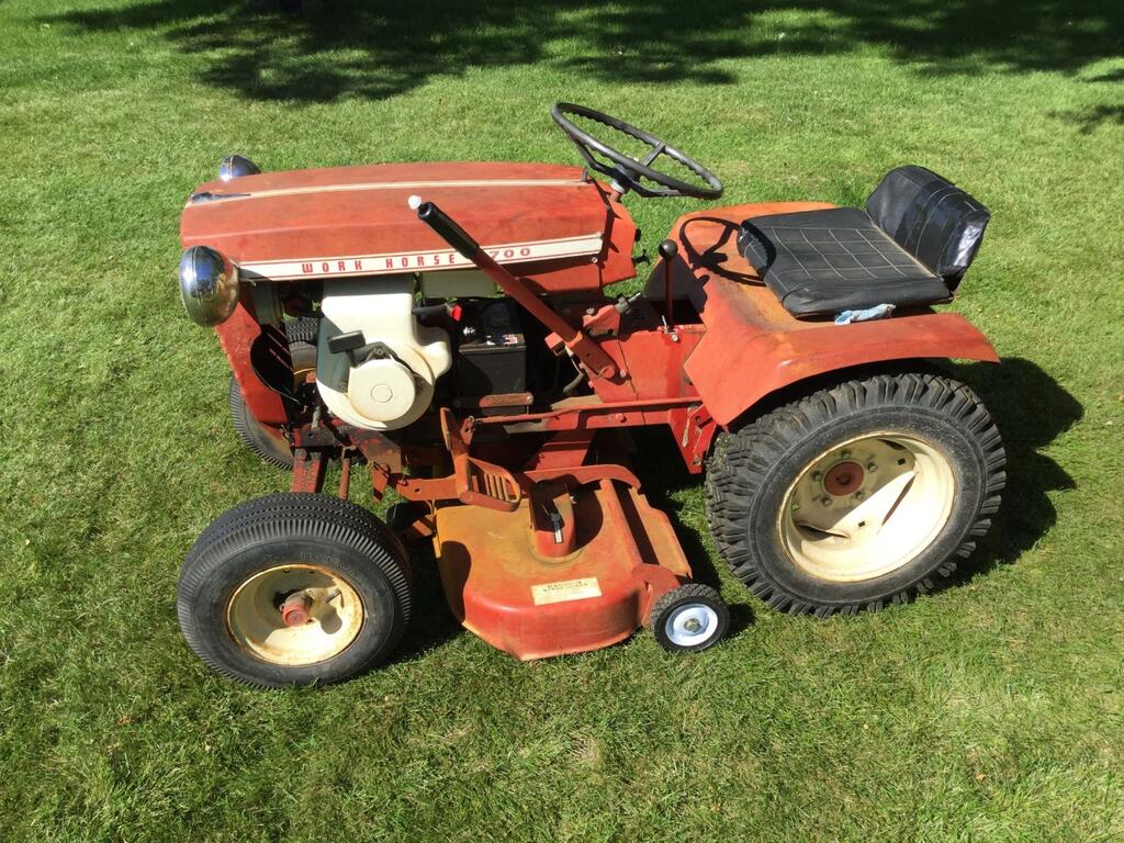

305 380 #1 Posted May 21, 2021 my 1969 Workhorse 700 with the idea of replacing the bushings in the front wheels. to my surprise it already had ball bearings. checking my 1968 Commando 6 it too has ball bearings. i never had them apart before , just greased the crap out of them. did they come this way or did someone beat me to it? i know for a fact my 1968 Lawn Ranger has bushings 1 1 Share this post Link to post Share on other sites
squonk 43,939 #2 Posted May 21, 2021 16 minutes ago, 305 said: my 1969 Workhorse 700 with the idea of replacing the bushings in the front wheels. to my surprise it already had ball bearings. checking my 1968 Commando 6 it too has ball bearings. i never had them apart before , just greased the crap out of them. did they come this way or did someone beat me to it? i know for a fact my 1968 Lawn Ranger has bushings Are you talking bearings like this: Or bearings like this? Share this post Link to post Share on other sites
305 380 #3 Posted May 21, 2021 flanged seal bearing like the top one Share this post Link to post Share on other sites
squonk 43,939 #4 Posted May 21, 2021 5 minutes ago, 305 said: flanged seal bearing like the top one That one is pretty much stock after the early 60's 1 Share this post Link to post Share on other sites
305 380 #5 Posted May 21, 2021 good to know , for some reason i always thought they just had bushings. they never felt loose. i had purchased them a while ago and the job was on my to do list thanks for the help. i now have spares 4 Share this post Link to post Share on other sites
Achto 29,420 #6 Posted May 21, 2021 23 minutes ago, 305 said: With a sealed bearing like the one pictured, I commonly remove the inside seal but leave the outside seal on. This way grease can get to them when you fill through the zert, yet it keeps dirt and water from getting to the bearing from the outside. 3 Share this post Link to post Share on other sites
rmaynard 16,363 #7 Posted May 21, 2021 If I'm restoring a tractor for show, I will use a sealed bearing and never grease the zerk. Stays cleaner. When replacing bearings in a worker, I use the open back type and grease the heck out of them. As far as bushings, I had them in my '61 701 and '67 Lawn Skiff. 1 Share this post Link to post Share on other sites
pfrederi 18,711 #8 Posted May 21, 2021 Lawn rangers used bushings... Share this post Link to post Share on other sites
Pollack Pete 2,273 #9 Posted May 21, 2021 After mowing a couple days ago with my C-175,I noticed one VERY wobbly front wheel.Jacked up the front end and pulled the wheel off.The bearing fell apart.Went into my parts bin and got out 2 new bearings.They had the rubber seals on the inside.I removed the seals,installed the bearings,put the wheel back on and greased the snot out of them along with the other front wheel,the axle pivot,and the 3 mower deck spindles.Good for another 3 thousand miles.BTW,the replacement bearings I used were Heim brand.Seems like real high quality bearings. Share this post Link to post Share on other sites
Terry M-(Moderator) 2,240 #10 Posted May 21, 2021 I’ve owned seven lawn rangers...one from each year 1962 thru 1968 and those all originally came with front wheel bushings. All of the 60’s short frames that I have/ had originally came with front wheel bearings. Just my Share this post Link to post Share on other sites
305 380 #11 Posted May 22, 2021 yeah , i knew that my Lawn Ranger had bushings , i just assumed the 700 workhorse did too now i know they have bearings Share this post Link to post Share on other sites
