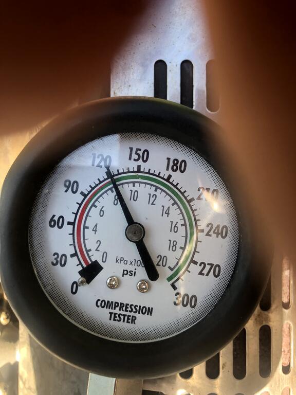

lynnmor 8,628 #2 Posted May 18, 2021 The first thing to check is the compression. Fouling plugs may be coming from bad rings and no tuneup will fix that. If the compression is OK, then clean the carburetor. It is virtually impossible to diagnose ignition problems by the color of the spark, download the Onan Service Manual on this site and follow the tests there. Manual Share this post Link to post Share on other sites

kawimaniac2145 6 #4 Posted May 18, 2021 i got 120 on both cylinders. and looked inside the carb last night and was clean no obstructions. what should i do now any help's appreciated. Share this post Link to post Share on other sites
lynnmor 8,628 #5 Posted May 19, 2021 Compression is great, when you looked in the carburetor was it completely disassembled, or did you just peer down from the top? Share this post Link to post Share on other sites

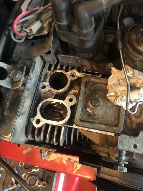

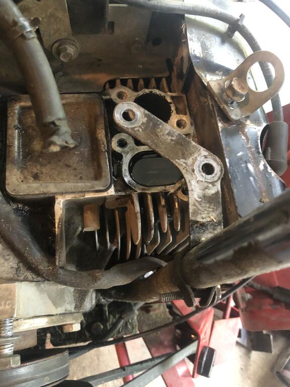

kawimaniac2145 6 #8 Posted May 19, 2021 is there supposed to be gas in the intake. and if not how do i fix it? Share this post Link to post Share on other sites
lynnmor 8,628 #9 Posted May 20, 2021 There should be no gas in the port, it is possible to get a small amount in while removing the intake if you don't keep it level. It appears that your carburetor needle valve is not stopping the flow, and needs to be inspected to find the problem. You may have gas in the oil if this was an ongoing problem, an immediate oil change may be in order. I would use paper towels to soak up the fuel. Share this post Link to post Share on other sites
