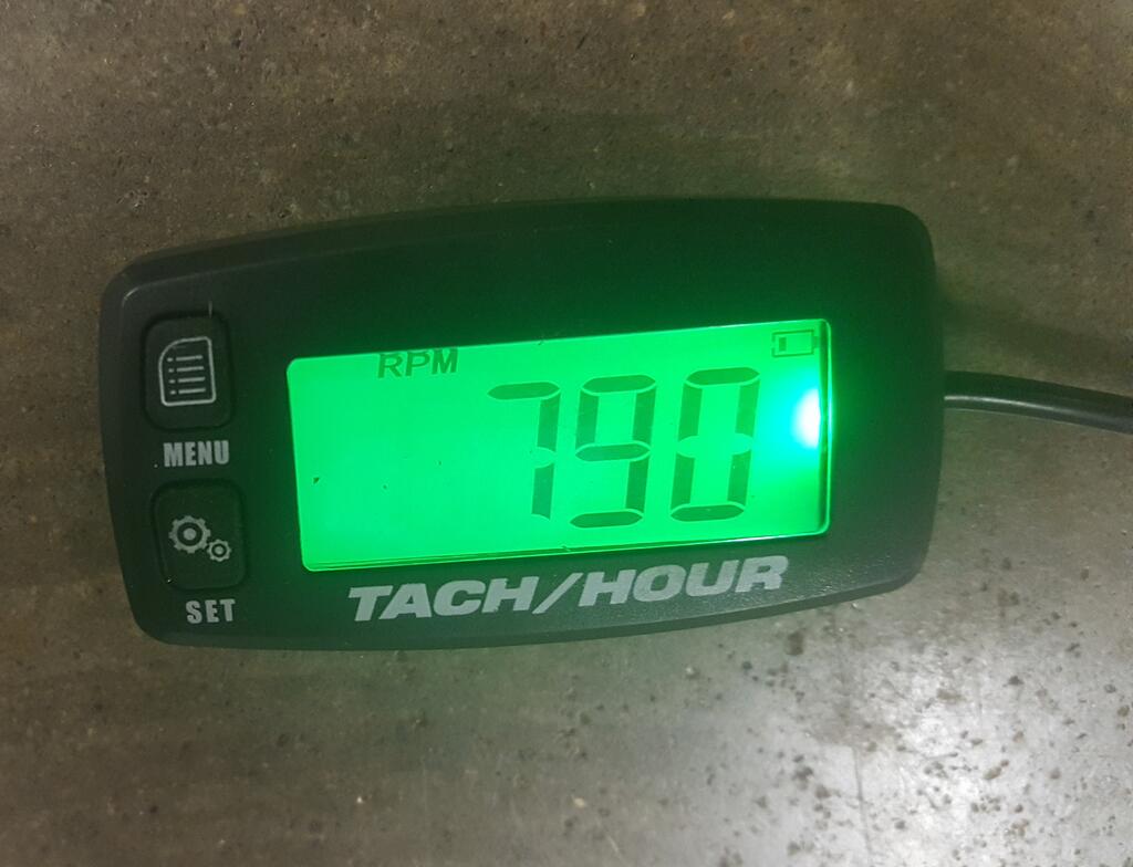

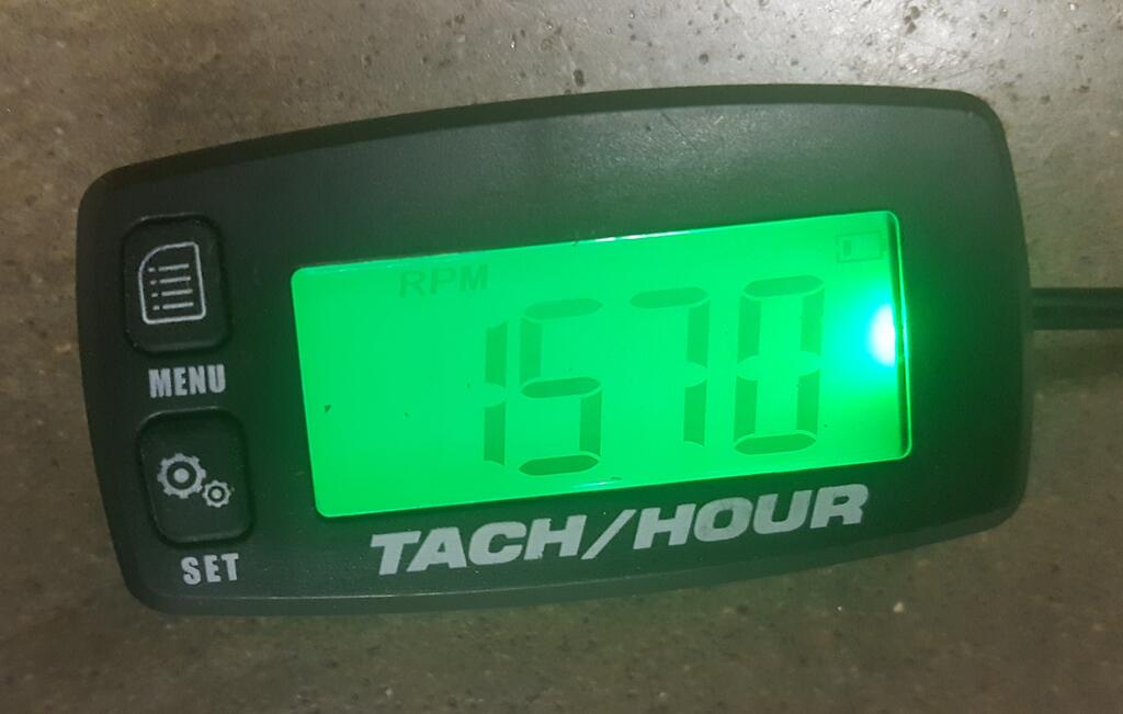

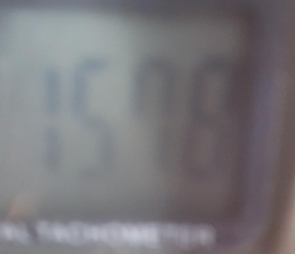

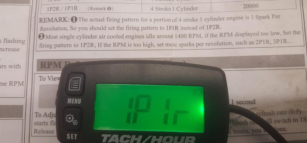

Gregor 4,848 #37 Posted May 19, 2021 Kohler 8 HP with battery ignition The 2 tachs. 1P1r 4 wraps 1P2r 4 wraps Digital hand held Not easy to see 1578 I tried both 4 and 5 wraps around plug wire. didn't seem to make much difference. 1 Share this post Link to post Share on other sites

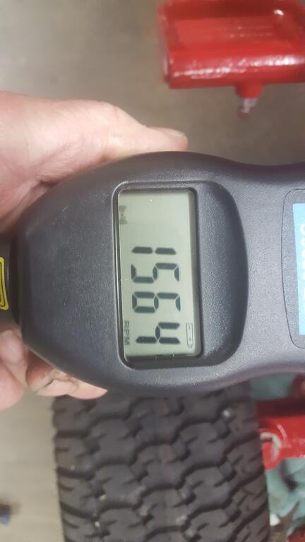

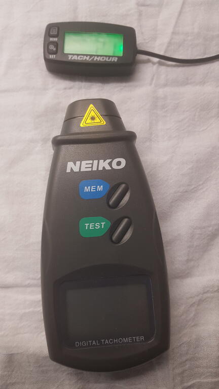

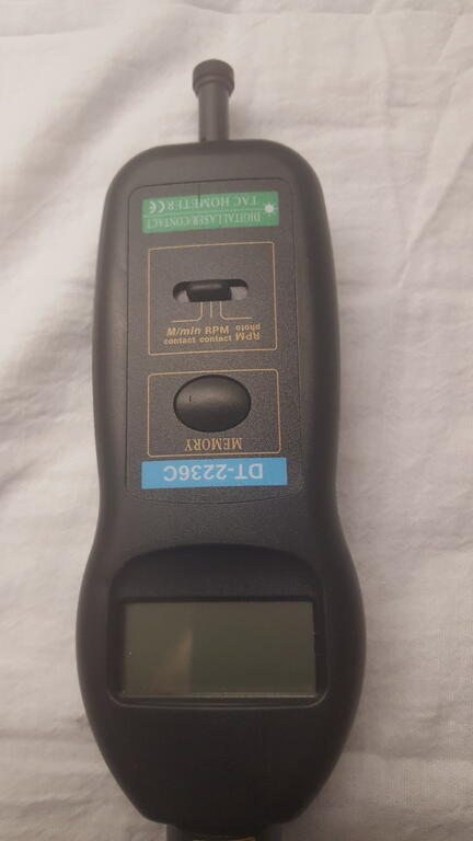

Gregor 4,848 #39 Posted May 19, 2021 (edited) And since I have another tach, may as well check that one out. This one is both a contact, and a laser. I think the contact type is the easiest to use. No guessing on the # of wraps. No applying reflective tape, and then trying to hold your laser steady on that tape. Hold the tach on the end of the shaft, your done. After taking all these readings, I adjusted my idle back down to 1300 RPM. Not sure what it should be. Edited May 19, 2021 by Gregor Share this post Link to post Share on other sites
ebinmaine 81,156 #40 Posted May 19, 2021 2 minutes ago, Gregor said: adjusted my idle back down to 1300 RPM. Not sure what it should be. Should be 1200 RPM. That said, my c-160 doesn't like to run right below 1250 or 1300 for some reason and that's with two different carburetors on it. So I leave the idle about 1300, 1350. To be honest I don't know that it matters all that much because these air-cooled engines should NEVER be at idle unless they're about to be shut off. Share this post Link to post Share on other sites

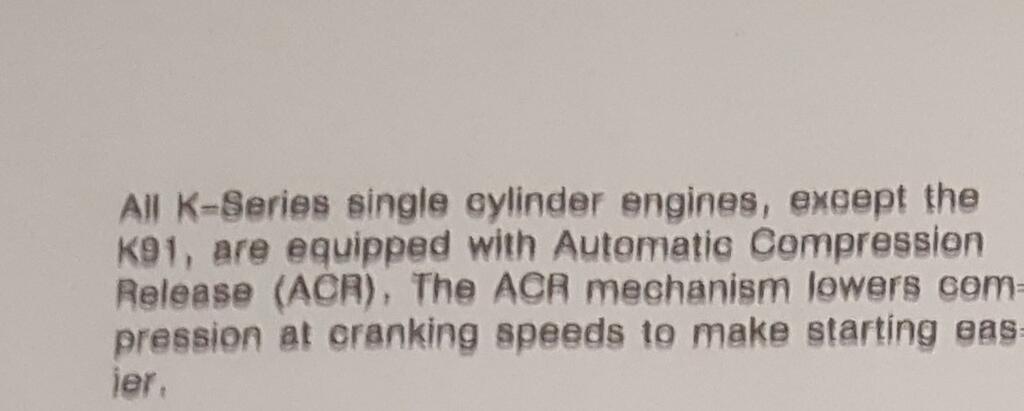

Tractorhead 9,218 #43 Posted May 19, 2021 I don’t know if the Kohlers have a auto decompression, that can be the cause of the needed higher idle. 1 Share this post Link to post Share on other sites
BOB ELLISON 2,983 #44 Posted May 19, 2021 Yes I did a post on this i just had to find it. The tachometer is still working fine. 1 Share this post Link to post Share on other sites
Gregor 4,848 #45 Posted May 19, 2021 51 minutes ago, Tractorhead said: I don’t know if the Kohlers have a auto decompression, that can be the cause of the needed higher idle. Share this post Link to post Share on other sites

seuadr 490 #47 Posted May 20, 2021 On 5/19/2021 at 5:03 AM, Gregor said: Kohler 8 HP with battery ignition The 2 tachs. I tried both 4 and 5 wraps around plug wire. didn't seem to make much difference. thanks for sharing your results - i was just looking at that unit because i also need an hour meter and well, 2 for 1, right?! Share this post Link to post Share on other sites
Gregor 4,848 #48 Posted May 20, 2021 The only bad thing about this unit is, you cannot shut it off. There is no switch. I always remove the battery. It does not seem to lose it's data though. It keeps the total hours. Share this post Link to post Share on other sites
Charbs152 257 #49 Posted May 20, 2021 On 5/18/2021 at 7:26 AM, Gregor said: MMmmm Are you sure? The tiny tachs i've used have settings for different firing orders for different engine designs 2 Share this post Link to post Share on other sites
seuadr 490 #50 Posted May 20, 2021 4 minutes ago, Gregor said: The only bad thing about this unit is, you cannot shut it off. There is no switch. I always remove the battery. It does not seem to lose it's data though. It keeps the total hours. oh. the description suggested that it turns on when it senses spark 2 Share this post Link to post Share on other sites
