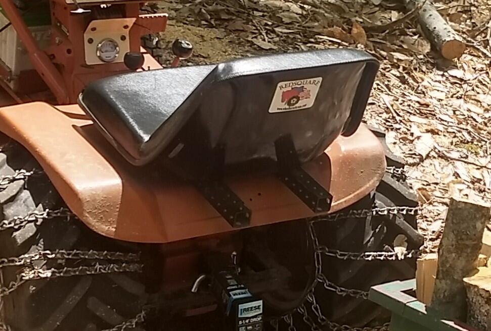

ebinmaine 80,628 #2 Posted May 16, 2021 Do you have the tilt back seat pan? If so you NEED to make SURE the latch is fully contacting. I'm 6'1"+ and 2@#$ ALOT of pounds so I moved the seat back (( 2" ??)) on my 74 C160. I used 1.5" square multi hole steel. It's a bit of a distance shot. You can see what I did here. Share this post Link to post Share on other sites

Maxwell-8 4,371 #8 Posted May 17, 2021 13 hours ago, ebinmaine said: Where can i get one of those fancy stickers! 1 Share this post Link to post Share on other sites
ebinmaine 80,628 #9 Posted May 17, 2021 15 minutes ago, Maxwell-8 said: Where can i get one of those fancy stickers! I believe I got that from Terry the vinyl guy 1 Share this post Link to post Share on other sites
