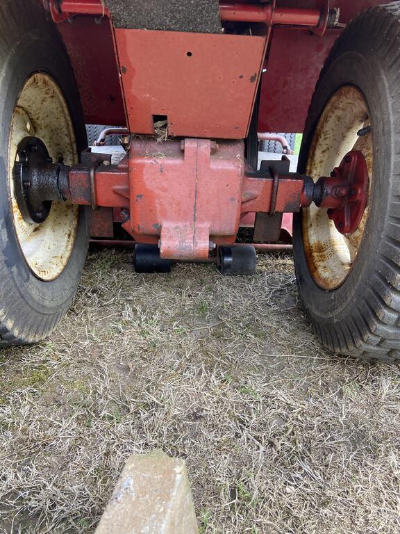

stevasaurus 23,627 #5 Posted May 16, 2021 Excellent, we were all out of our league when we joined here...it is OK. There is a support with a pulley that guides the belt. did you find a manual?? The last picture shows something bolted to your axles on the trans...not sure what that is. Thinking it should be a attach-a-matic thingy. Need some other guys to hop in here. We do have the answers for you. That is a regular tiller...it should work fine. Share this post Link to post Share on other sites

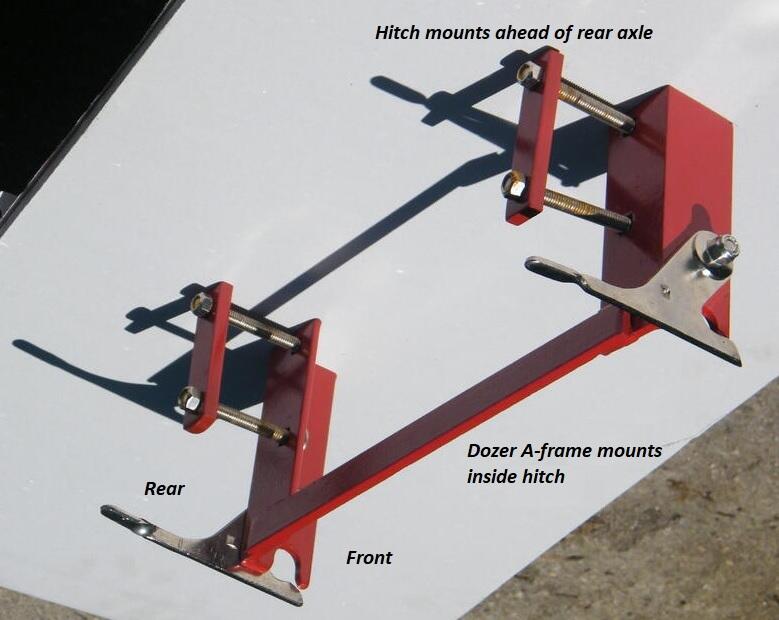

gwest_ca-(File Mod) 12,015 #6 Posted May 16, 2021 Click on the picture in each link for more info on each model The rear axle hitch you have is for the earlier dozer blades. You need a hitch that mounts under the axle housing instead of in front of it. It is illustrated in the tiller manual. This list shows where the front mounted hitch was used Dozer DNA of long tractor frame dozer blades 1966-1967 model BD-426 - Fits LONG frame tractors - Mounts ahead of the rear axle - replaced by 1968 model 6-1111 - Fits LONG frame tractors - Mounts ahead of the rear axle ---------------------------------------------------------------------------------------------------------------------- 1968 model 6-4111 - First to fit LONG & SHORT frame tractors and first to mount under the rear axle with a loose A-frame crossbar - replaced by 1969 model [6-4112 + 6-9621] 1970-73 model [6-4113 + 6-9622] 1973-74 model [6-4113 + 6-9623] 1974 model [6-4114 + 6-9624] 1974 model 6-2131 1975 model 6-2132 1976 model 6-2133 1976 model 66-42BC01 1977 model 76-42BC01 1978 model 86-42BC01 1979 model 96-42BC01 1980 model 06-42BC01 - (Last blade to have a loose A-frame crossbar #7701) 1981-1984 model 06-42BC02 (Up to here including this one they are 42" wide) and (First blade to have a welded-in rear A-frame crossbar) 1984-1989 model 06-48BC01 (They are now 48" wide) - replaced by the following 1990 model 06-48BC02 (Last blade to have 3 angle positions) 1991-1993 model 06-48BC03 (First blade to have 5 angle positions) 1993-2001 model 79350 - (105-1502 kit adapts 2001 and older GT Classic-Series blades to fit 2002 and later tractors 2002 2004-2009 2012 model 79364 - (105-1501 kit adapts 79364 blade to fit 2001 and older GT Classic-Series) Keep the questions coming Garry 1 1 Share this post Link to post Share on other sites

oliver2-44 11,272 #9 Posted May 17, 2021 (edited) One of our vendors WheelHorse parts and More has lots of reproductions parts to help keep our horses going. For your tiller you will need an idler pulley bracket and misc parts. He has 2 models, the manual and some of the guys will help you figure which one you need. Here is a link to one of them to give you the general idea https://wheelhorsepartsandmore.com/product/wheel-horse-toro-tiller-bracket-with-guard/ The 12hp and an 8 speed will do everything you ask of it. As WHX24 mentioned the snow dozer blade is excellent for pushing gravel or some landscape work. I have rear weights and chains on a 16hp and have moved a lot of dirt with it. It looks like the transmission rear seals are leaking on your tractor. be sure to check the transmission oil level before you do much work with it. It uses 80/90 weigh gear oil, any brand is fine. When you get around to replacing those axle seals, come back here and talk to guys about how to remove the wheel hubs. They are cast iron and brittle/a little fragile. Edited May 17, 2021 by oliver2-44 2 Share this post Link to post Share on other sites

Pullstart 68,981 #12 Posted May 17, 2021 the plow bracket on the rear axle looks a bit custom. Hopefully you have the correct one for your tiller as that will not work well for you. seeing the odds and ends parts you have could help us let you know where they should go.. 1 Share this post Link to post Share on other sites
WHX?? 55,252 #13 Posted May 17, 2021 Some body has also had at least the left rear hub off, probably broke it getting it off hence the late style hub. I would pull the wheels and check the bearings seals & keys. You will also need that mid mount idler to run the tiller. Share this post Link to post Share on other sites
Lee1977 7,575 #14 Posted May 17, 2021 1 hour ago, pullstart said: the plow bracket on the rear axle looks a bit custom. Hopefully you have the correct one for your tiller as that will not work well for you. seeing the odds and ends parts you have could help us let you know where they should go.. That bracket should work if it turned around and installed on the back side of the axle housing. If in the loose parts you have look for one that installs on the bottom of the axle it will work with both the tiller and snow blade. Share this post Link to post Share on other sites

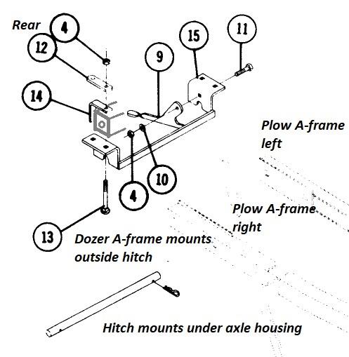

gwest_ca-(File Mod) 12,015 #20 Posted May 20, 2021 I believe the hitch above is the hitch you have mounted on the front of the axle housing. Here is the one that mounts under the axle housing for dozers and tillers on your 1973 tractor. Share this post Link to post Share on other sites

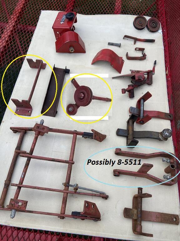

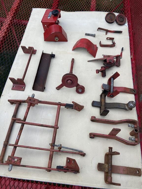

GMcC 13 #21 Posted May 20, 2021 This is a snapshot of the pile of parts he gave to me ( along with a couple or so items I got when I purchased the 1973 Wheel Horse 12-8 a few week earlier). Share this post Link to post Share on other sites
kpinnc 17,290 #22 Posted May 20, 2021 (edited) That's the tiller hitch on the left 2nd row. Just move the clips and brackets over to it and you'll be set. The pulley bracket in the middle also goes with it. Edited May 20, 2021 by kpinnc Share this post Link to post Share on other sites
gwest_ca-(File Mod) 12,015 #23 Posted May 20, 2021 These are used with the tiller. You could use the flat bars off the rear hitch on the other tractor I think. Clevis hitch used for rear attachments other than tiller. Share this post Link to post Share on other sites
