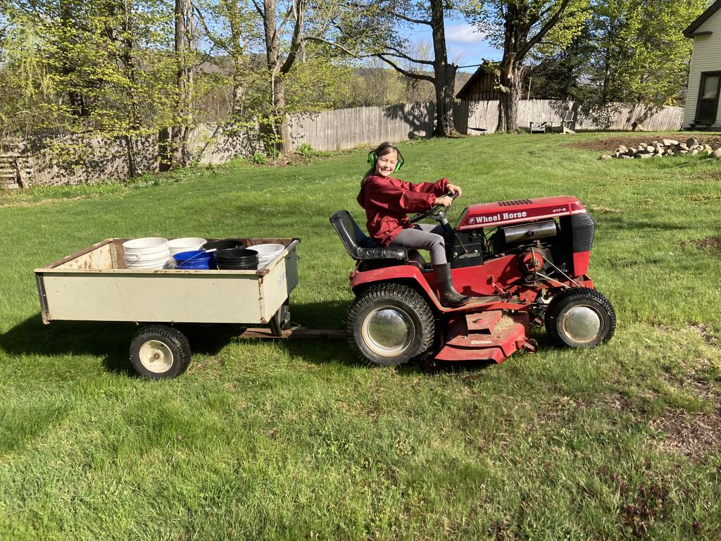

Seth Powers 35 #1 Posted May 14, 2021 Attached is a picture of my daughter enjoying the 417-8 just a few days ago. She loves driving that tractor! However, I am worried that I have ruined it. I forgot to change the air filter thing from the winter to summer mode. My son was mowing the grass yesterday and it was pretty warm. He was mowing along and I came home, so he stopped. When we tried to start the engine again it would just click like the electrical was doing something (I could lift the deck up), but the engine wouldn't turn over at all. I tried it a couple of times to no avail. I took off the front left screen to see if that part would turn and it did but kind of hard. After that, my daughter tried turning it over and it turned over and then stopped - all electrical failed after that. I did change the 25 watt fuse, which was blown. I have no idea what a seized engine is like. The engine has plenty of oil. Last night I tried jumping it with my Pilot (with the engine off) to no avail - couldn't get any electrical thing to do anything. When it has worked, it has been a marvelous tractor and I think it looks great. I was harrowing with it last week and it is just such a nice tractor. I know my terminology is vague and I apologize for that - we all have areas of expertise and small engine mechanical jargon is not mine. Any help will be appreciated as so many of you have been marvelous about other issues I have had. 1 Share this post Link to post Share on other sites
