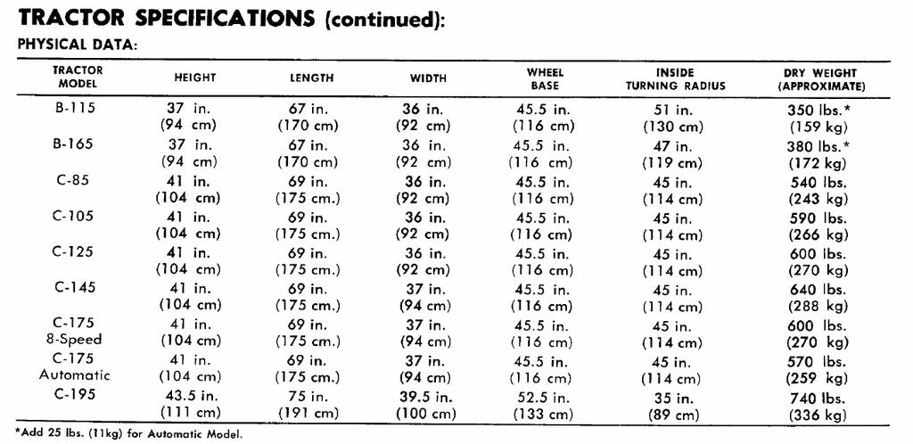

Hi all.hope someone can help.would like to know the chassis length of a c195.how much longer at front and at rear.thanks in advance.
gwest_ca
From the 1982 operator manual

On the front end, they're really not much different than a regular C.  The rear end seems to be stretched to accommodate the larger tires.   I had a C195 for a time that I took a few pictures of while it was parked next to my C165 that has the swept forward axle.  The post of it is here.
