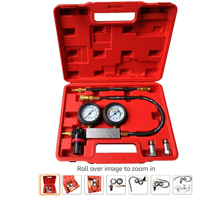

Gregor 4,848 #32 Posted May 12, 2021 Leak down tester. Anywhere from $30 on up. 1 Share this post Link to post Share on other sites
Stormin 9,988 #33 Posted May 12, 2021 Thanks for the suggestion, but for one use onIy I can't justify the cost. Share this post Link to post Share on other sites
