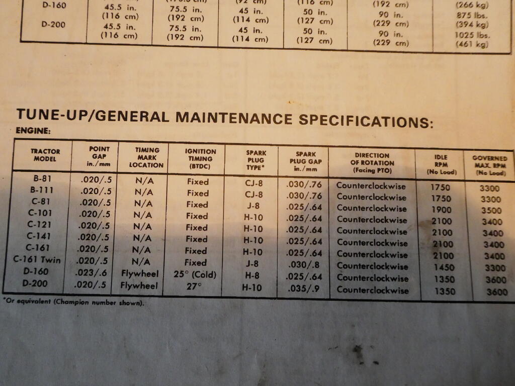

Stormin 9,988 #13 Posted May 9, 2021 Been having a play this morning. Change condenser and then plug lead. No change. One problem has been I think, I've been trying to get to slow an idle speed. I was brought up on long stroke ohv single cylinder motorcycle engines. So I decided to see what it was running at. Should be, according to the manual 2,100 rpm. I have a digital hand held rev' counter and after taking off the pto pulley so I could get at the end of the crankshaft it read, 2,090ish. Slight fluctuation but negatable. That'll do me for now. Share this post Link to post Share on other sites

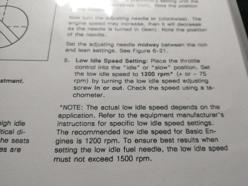

squonk 47,885 #15 Posted May 9, 2021 (edited) nORMSTER, my Kohler manual says 1200RPM for idle. Where did you get 2100 or do you have dyslexia? If I ran my C-160 that high when I shut it off it would blow my muffler clear to Chineee! Edited May 9, 2021 by squonk 3 Share this post Link to post Share on other sites

Stormin 9,988 #17 Posted May 9, 2021 mIKe. Just had a look in the Kohler manual in here. 1,200. I'll check what I have. 2,000 did seem some what high. And I do need to get an eye test. 2 Share this post Link to post Share on other sites
Stormin 9,988 #18 Posted May 9, 2021 Well I've had another go it this afternoon. First I checked the points gap. Was a little tight. Set at .020" thou now. What a maul to adjust those points. You need a touch like an elephants midwife. Anyway, after much messing about I've got it to idle? between 1,500 - 1,600. It'll run fine for about a minute or two then slow down, splutter and pop then die. I've removed the mixture adjusting screws and blown out the jets. I'm starting to wonder if the fuel pump is not delivering enough fuel at low rev's. I've two spare so I'll try those. Not today though. I've had enough. BTW Squonk here's the manual print out I was given when I got the C-81. Doesn't cover the C-125 but does the C-121. Same engine except for the throttle cable - governor set up. Says A B C D down the left hand side. Share this post Link to post Share on other sites
