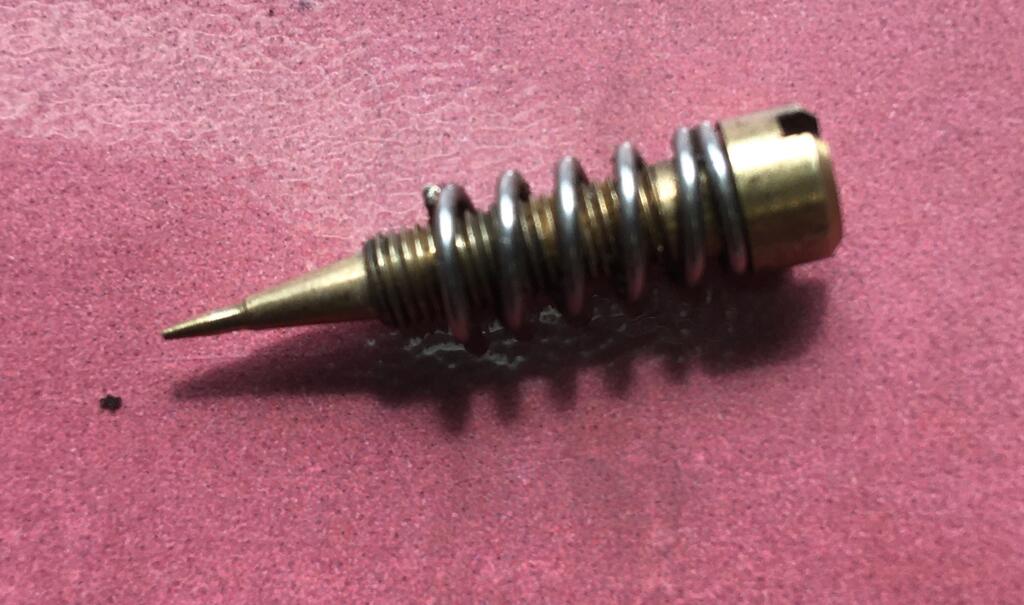

Further to this thread, this is the idle mixture screw from that carb.  Note the step in the needle profile. I haven't been able to find a good image in either the user's manual or the parts book, but it looks to me like the needle has been damaged at one time. Can anyone confirm whether that step is normal or not?
I've also been unable to find this part as a separate item anywhere - it seems that I'd have to buy a complete carb kit ($200) to replace it, so any other ideas would be most welcome.
