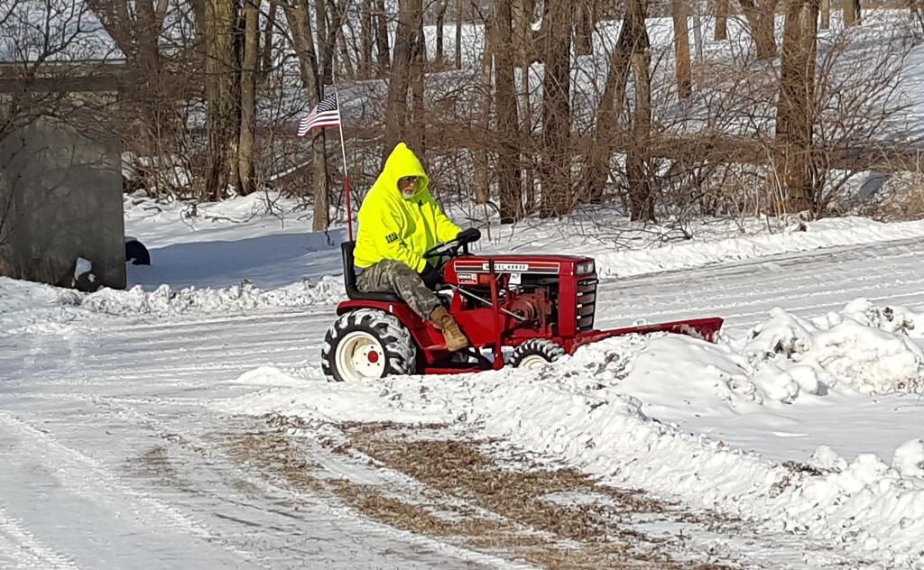

Rusty Tinsnips 477 #1 Posted May 6, 2021 Both my horses don't run like they did plowing snow this last winter. I haven't had time to tweak the carbs but I think that's what's is wrong with them. Nothing serious, just a little surge at full throttle on both that was not there in the winter. Do they need constant adjustments? Both carbs were rebuilt last year and ran great all winter. 1 Share this post Link to post Share on other sites
