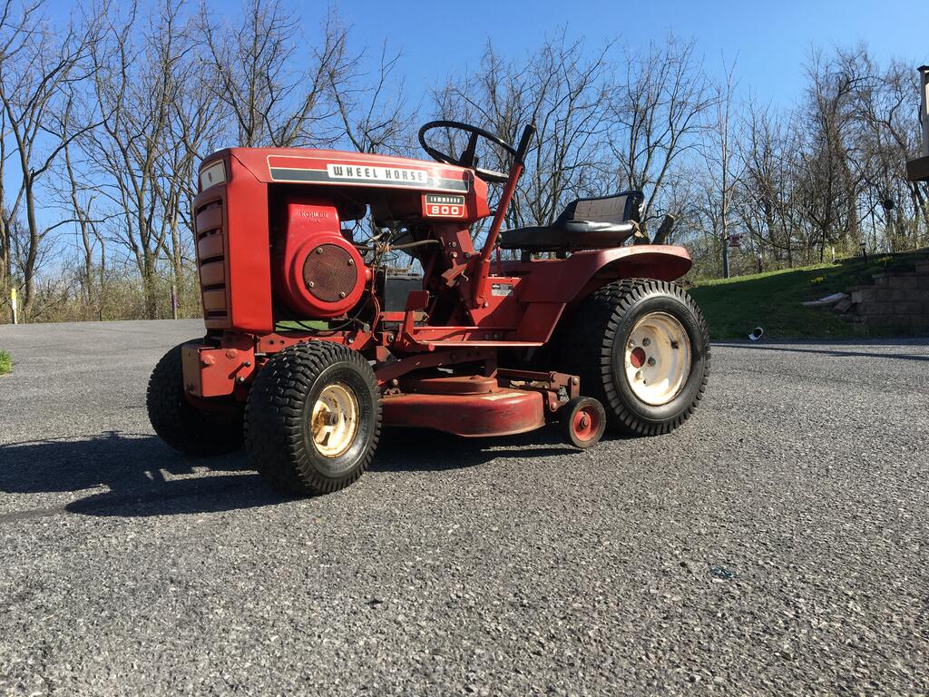

Commando800 32 #1 Posted April 30, 2021 I’m having an issue with my 1971 commando 800 she’s daily driver but inspected well the issue I’m having is when I put my right foot on the floor board and have pressure just sitting then it make this metal vibration noise but when I get off the tractor and I lift the floor board up there no noise I think it’s the pulley for the transmission hitting the cover but I’m not sure how to resolve it thank you everyone! 3 1 1 Share this post Link to post Share on other sites
