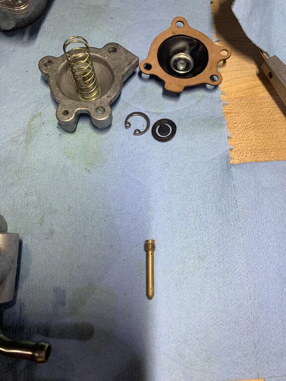

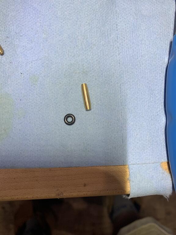

vintagez 1 #1 Posted April 29, 2021 (edited) Hey all! I have a pretty heavy surging at idle with the emissions style carb. Taken it apart a few times now and cannot figure it out. However, I might be onto something. I took the accelerator pump apart because I bought a rebuild kit. The kit comes with two components (small o-ring and a brass shaft) that my carb did not have. With that said, I can’t find an exploded view of my carb or a schematic. Anyone have one? The first picture shows what came out of mine and the second are the extra parts from the new kit. Also, I want to make sure that one of the jets i pulled out is not damaged, I though that this jet would come to a fine needle point at the end. I’m thinking if that’s the case, someone bottomed out the jet and it broke off. This will be picture 1 at the bottom. Edited April 29, 2021 by vintagez Share this post Link to post Share on other sites
buckrancher 2,695 #2 Posted April 29, 2021 you seem to be missing the ball check and spring Share this post Link to post Share on other sites
lynnmor 8,628 #3 Posted April 29, 2021 4 hours ago, buckrancher said: you seem to be missing the ball check and spring That spring and ball can be seen here. Share this post Link to post Share on other sites
vintagez 1 #4 Posted April 30, 2021 Awesome, got it running nicely now! Just have to adjust the throttle cable to bring the idle down, it was around 1800. Gave a pop when I turned the key off (never did that before) but I’m hoping it was nothing. Didnt fire back up since it’s 11pm. I’ll report back if I find the intake is leaking and causing the backfire. Share this post Link to post Share on other sites
