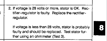

The Gman 476 #1 Posted April 28, 2021 Hi guys gals, trying to troubleshoot a charging issue on the 418. I only get 15+ ac volts out of the stator leads at full throttle. Before I take the flywheel of is there anything else I should check or look for? Thx Share this post Link to post Share on other sites

The Gman 476 #3 Posted April 28, 2021 8 minutes ago, Gregor said: How many do you want? LOL 30 to 35 would be good. 1 Share this post Link to post Share on other sites
Gregor 4,847 #4 Posted April 28, 2021 Just read this. Didn't realize it should be that high. 1 Share this post Link to post Share on other sites
Snoopy11 5,731 #5 Posted November 22, 2021 On 4/28/2021 at 6:59 PM, Gregor said: Just read this. Didn't realize it should be that high. I think it is that high pre-regulator, correct? Don Share this post Link to post Share on other sites
