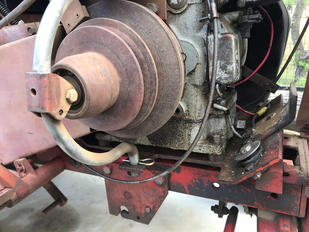

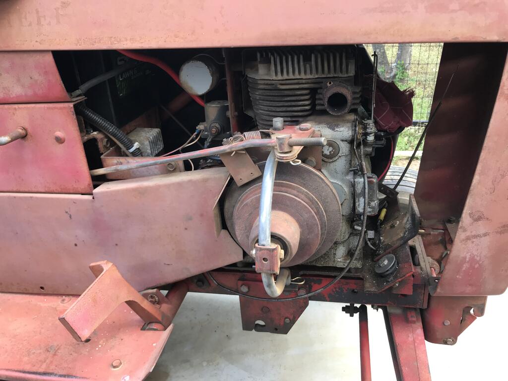

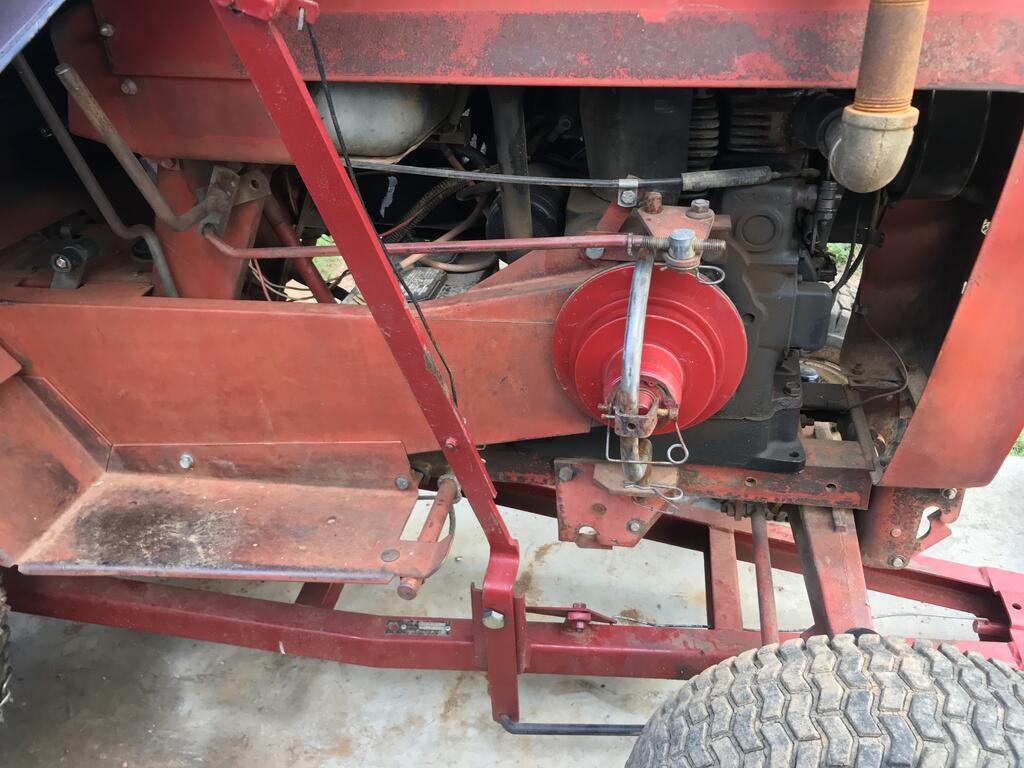

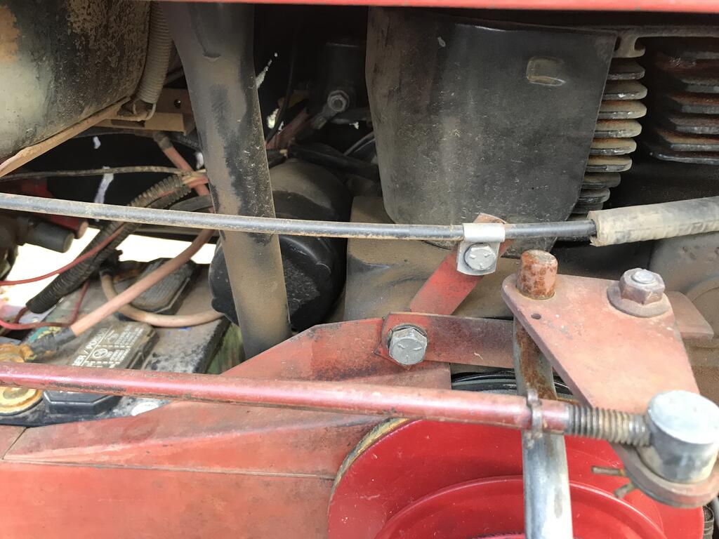

oliver2-44 11,214 #6 Posted April 28, 2021 @Coilovergto I have a C81 and C160 over at another location I will look at them later today. I will also measure/look at the belt guards to see if they are the same I seem to vaguely recal the mounting tab on the engine end was different . What others have indicated above is correct about removing the shaker plate and using an oil pan that the PTO side bolts from the bottom. Share this post Link to post Share on other sites

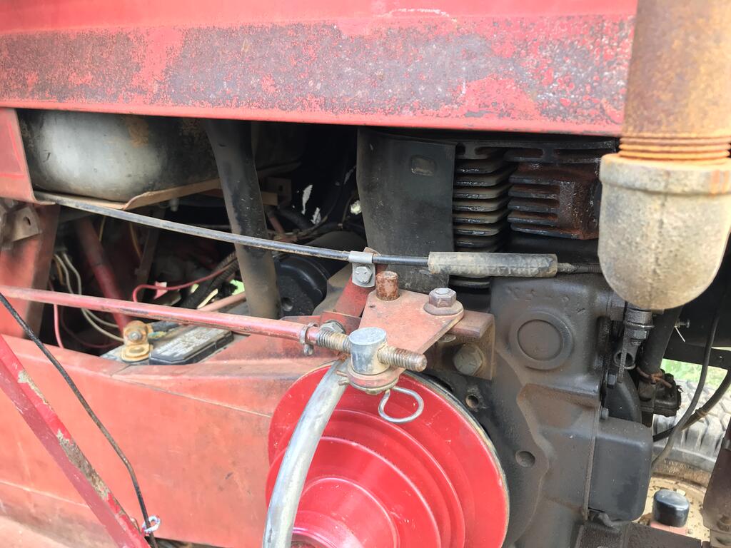

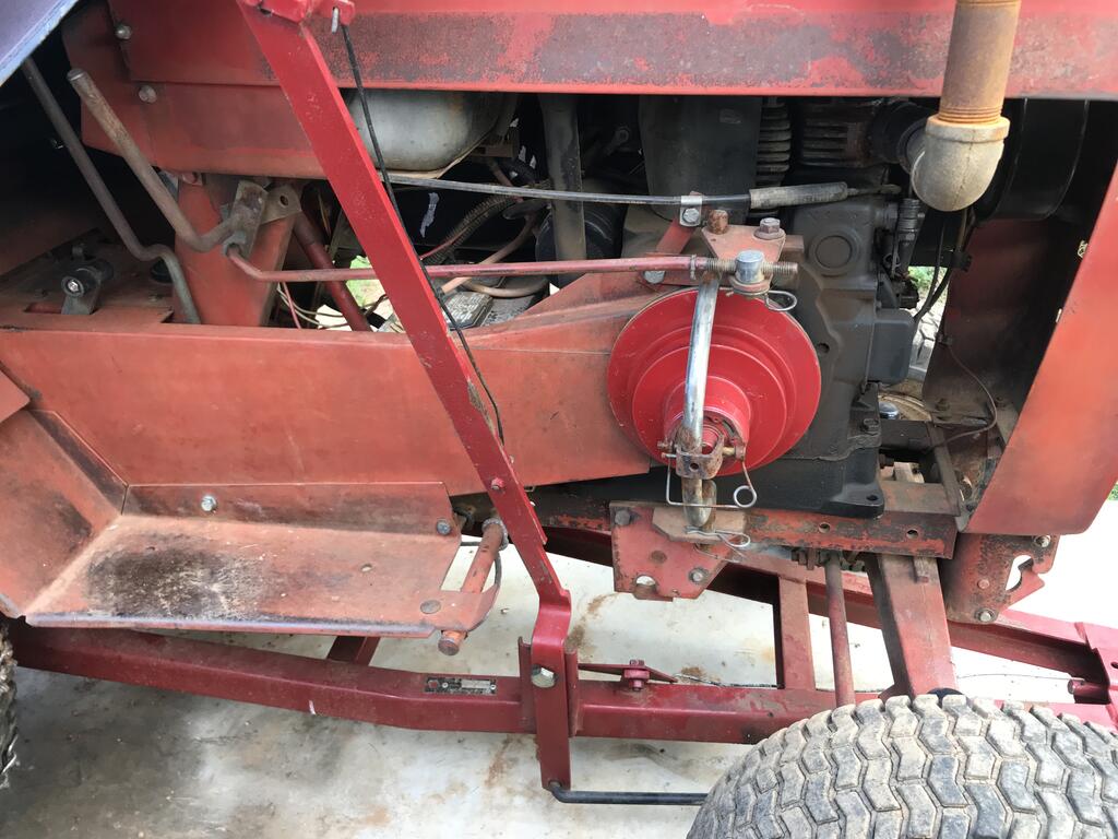

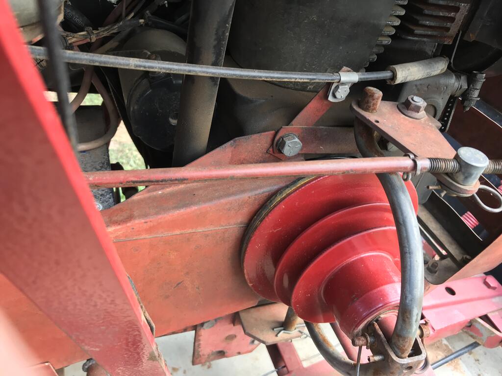

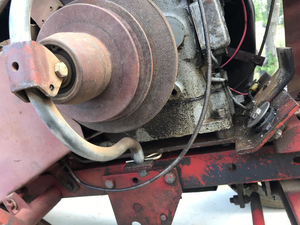

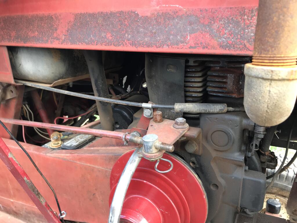

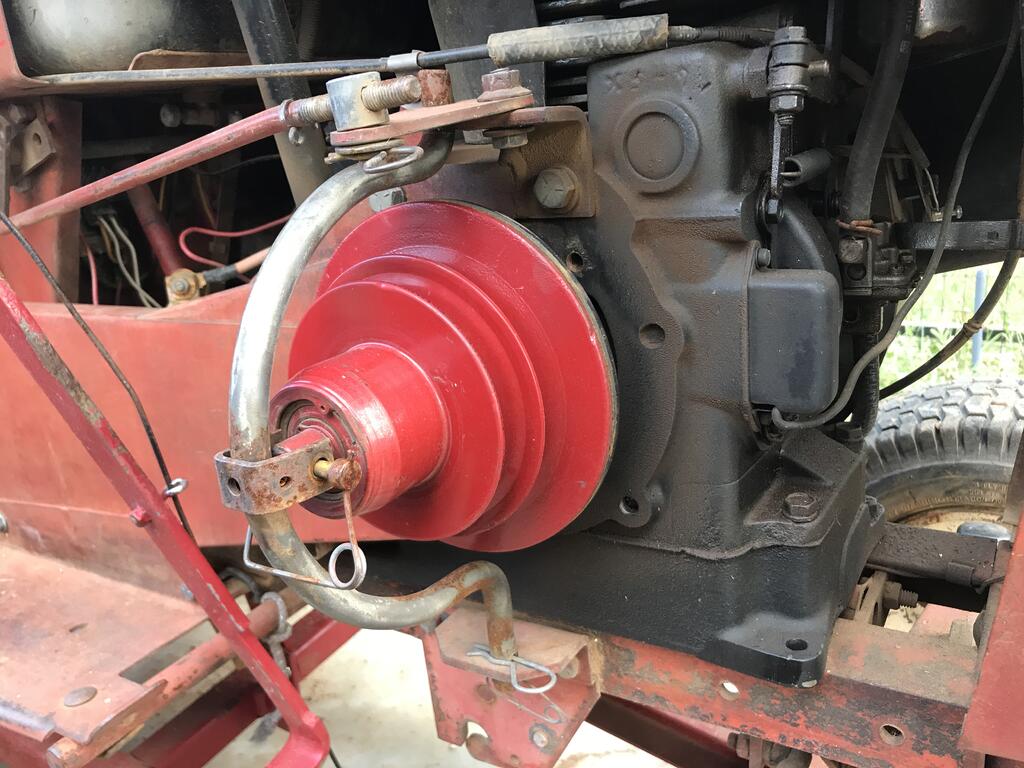

oliver2-44 11,214 #7 Posted April 29, 2021 @Coilovergto The pictures with the black kohler engine is my C160, the ones with the gray kohler are of my C-81 As you can see in this C-160 picture below the belt guard and its attachment at the engine is a little different. if you can weld sheet metal, you probable can make the C81 work, or you can get on from someone on here or A-Z tractor. You can check part numbers in the manuals section, but I suspect the C-100, through C-160 all have the same belt guard as they are all the same size Kohler block. Share this post Link to post Share on other sites
