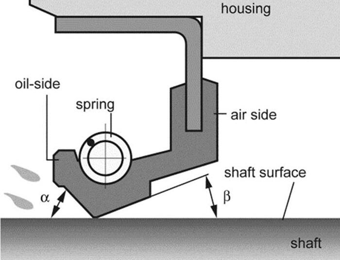

oliver2-44 11,717 #6 Posted April 28, 2021 (edited) The side of the seal that has the spring always faces the oil you are trying to contain Edited April 28, 2021 by oliver2-44 1 Share this post Link to post Share on other sites
