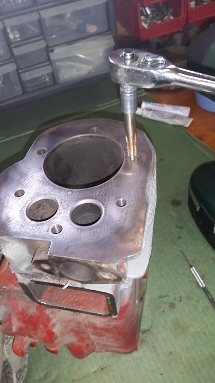

ranger 1,855 #33 Posted April 27, 2021 You said you cleaned the threads in the block for the head bolts? Are the bolts going far enough into the block to clamp the head fully? Head / block been skimmed / surfaced? I’ve seen auto blocks cracked because oil or water, (or “gunge”) from disassembly had not been cleaned out properly, head bolts when torqued down would, “ Hydraulic”, and crack the block, 1.6 and 1.9ltr VW diesels. I always run an appropriately sized drill bit, (using my fingers), into each threaded hole It’s surprising what you can sometimes get out of the bottom of a “clean” hole! Have the gaskets failed in the same place each time? Does the rattle sound mechanical? Or could it be the failing gasket acting as a “Reed”, and vibrating? This would point towards block / head surfaces not clamping gasket sufficiently in places. I’ve also come across “Rattling” noises and clouds of smoke from Diesel engines that have been over filled with oil, this would pass through the breather / oil separator and feed the engine through the air filter/ manifold connection. “SCARY” when this happens, as engine runs away uncontrollably! With the very high compression ratios diesel engines have, compared to the Kohlers, I wouldn’t think this is the cause, unless, when it fails, there is oil all over everywhere. Nothing to do with this post, but I thought I would add it. I had one piece of equipment that kept running away on it’s own oil, only at max rpm, everything ok, oil level, breather etc. It turned out to be, A vacuum pump mounted on the alternator, which was lubricated from the engine, the drain went back to crankcase. This pump was connected to the brake servo, (diesel engine, no manifold depression for brake servo). The vacuum line non return valve had a small leak, this meant instead of pulling a vacuum in a closed circuit, the pump acted as an air compressor and pumped air into the crankcase via the oil return, this was a “Vane” pump, not diaphragm. The volume of air at high engine rpm’s completely overwhelmed the breather system! Doug. Share this post Link to post Share on other sites

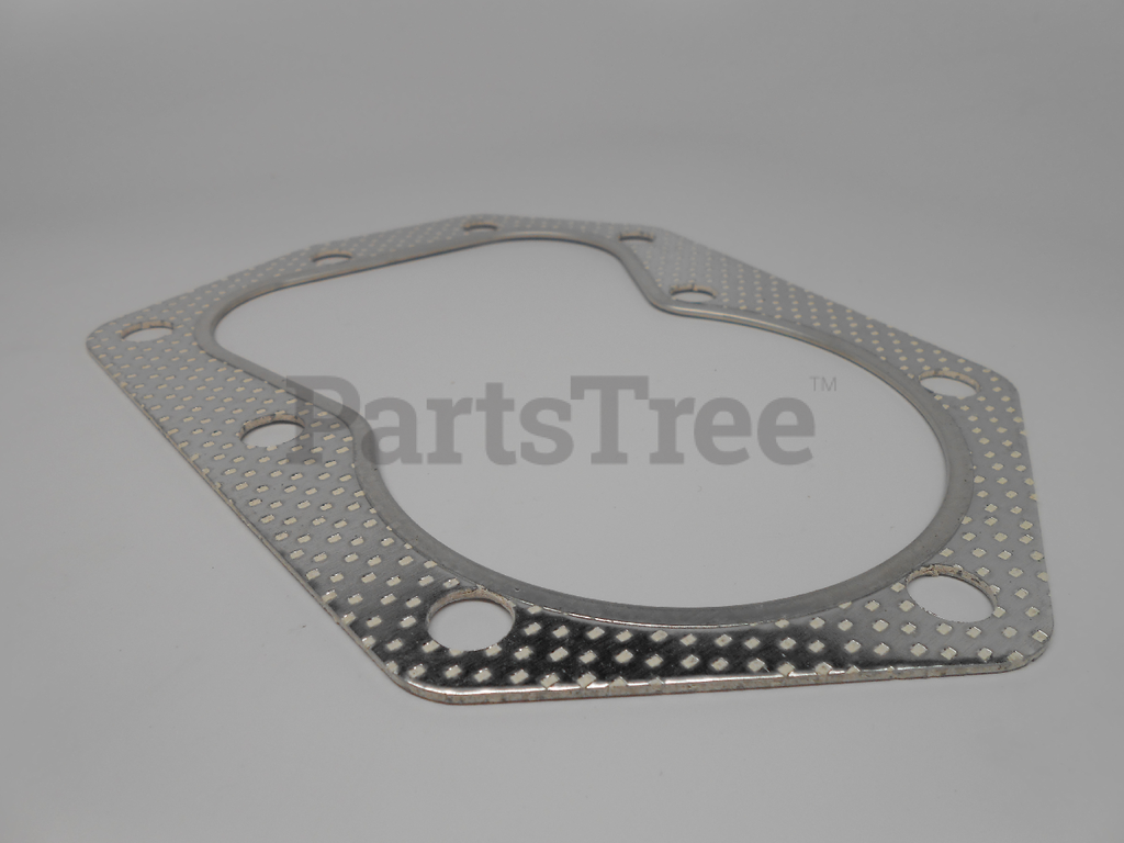

Greentored 3,220 #35 Posted April 29, 2021 Make sure you caught the reply from @WHX24. I had a similar issue with a 14hp and all was fine til I hooked up a plow and loaded it good. Lasted 2 passes. In a pinch, I grabbed the old oem Kohler gasket with fire ring out of the trash can and swapped it in. That was a year and at least 40 hours ago and its still perfect. If you are using one of the aftermarket rebuild kits, they normally come with the non fire ring gasket. Stens does offer the fire ring gasket but you have to ask the counter guy to specifically look it up and verify the pic. The next thing to do is to make sure none of your head bolts are bottoming out in the block and not actually pulling the head down. Seen that happen too. 2 Share this post Link to post Share on other sites
Achto 32,110 #36 Posted April 29, 2021 (edited) On 4/26/2021 at 4:16 PM, squonk said: I just looked at some pictures of a Kohler OEM 8 HP head gasket #41-041-10. No fire ring on them. They must have changed them. Hate it when the cost analysis department gets involved and ruin perfectly good parts. I have a few Kohler NOS small block gaskets that do have the fire ring on them. Edited April 29, 2021 by Achto 3 Share this post Link to post Share on other sites
Achto 32,110 #37 Posted April 29, 2021 20 minutes ago, Greentored said: The next thing to do is to make sure none of your head bolts are bottoming out in the block and not actually pulling the head down. Seen that happen too. Very good point. Seen this issue with new bolts and also when the thick washers on the head bolt were replaced with thinner ones. 3 Share this post Link to post Share on other sites
Gregor 4,848 #38 Posted April 29, 2021 My small engine guy once told me to run a thread chaser into the holes. "Don't use a tap, use a Thread Chaser" Well I have googled thread chaser, and all I come up with is taps. Is thread chase simply a bolt, with a slot cut down the threads? 1 Share this post Link to post Share on other sites
Gregor 4,848 #39 Posted April 29, 2021 The pic in the Parts Tree blow up, shows the head gasket with a fire ring. From what I can tell, you have to be a Stens dealer to order from them. At least that's what it says. 1 Share this post Link to post Share on other sites

Greentored 3,220 #41 Posted April 29, 2021 26 minutes ago, Gregor said: My small engine guy once told me to run a thread chaser into the holes. "Don't use a tap, use a Thread Chaser" Well I have googled thread chaser, and all I come up with is taps. Is thread chase simply a bolt, with a slot cut down the threads? Pretty much! For thread cleaning, not cutting, you can take a bolt of the correct size and grind 3 flats on it. Will work just fine. 1 Share this post Link to post Share on other sites
WHX?? 57,468 #42 Posted April 29, 2021 The past couple of builds on large blocks I used after market gaskets and not sure if they had a fire ring or not but they don't leak so they are not going to get torn down to check! I also did not glass the heads which I probably should have done. The one I have on the bench now, a 161, I did glass the head and was surprised at how much I had to work it to get it flat. 1 hour ago, Greentored said: old oem Kohler gasket with fire ring out of the trash can and swapped it in. While I don't promote using them over I have done this also with no problems. Heat of the battle thing and the urge to get it running again. On the bolts I have also pulled them out in an engine with all different lengths. Ok which one went where they all just got thrown in the parts box. Hence my reason for just using new ones WITH the thick washer as Dan mentioned. Find the thick washers in the drawers at TSC or MMC. All threads get chased with a standard bottom style tap and depth measured. 2 1 Share this post Link to post Share on other sites
squonk 47,422 #43 Posted April 29, 2021 (edited) Brand new Kohler OEM still in the bag No fire ring. Edited April 29, 2021 by squonk 1 2 1 Share this post Link to post Share on other sites
Howie 900 #44 Posted April 30, 2021 At least part of the time the longer bolts go around the exhaust valve. Unless some other spacer or something. I think the gasket set I get from my supplier does not have the head gasket with the fire ring in but the one you buy seperately does have, So I buy those, but ALWAYS run the engine thru a heat cycle and retorque. Gaskets without it require the retorque no exceptions in my opinion. 1 1 Share this post Link to post Share on other sites
953 nut 67,488 #45 Posted April 30, 2021 21 hours ago, squonk said: Brand new Kohler OEM still in the bag No fire ring. I bought a bunch of NOS Kohler parts a few years back and most of the head gaskets had no ring. 1 Share this post Link to post Share on other sites
Greentored 3,220 #46 Posted May 3, 2021 On 4/29/2021 at 9:52 AM, squonk said: Brand new Kohler OEM still in the bag No fire ring. That is so odd. Perhaps a later, running change or supplier change? Granted Im still a bit new to the Kohlers, but have torn at least 15-20 apart and have never seen one without the fire ring. How about you guys? 1 Share this post Link to post Share on other sites
squonk 47,422 #47 Posted May 3, 2021 I have seen the fire rings on only the 10 HP and up. Share this post Link to post Share on other sites
