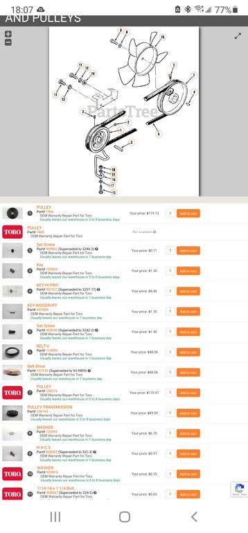

Can anyone tell me the part # or the belt length for the drive belt on a  1990 520-8?   Thank you

I don't know why that's so blurry.
Shows 3 part numbers 114895,107939, and 93-9809. All are 5/8 x 83.
Not sure of the difference between the different part numbers.

41-20o801, correct?

Tractor drive belt  107939 replaced by 93-9809 - (HB x 83.5" or 5/8" x 83-1/2")
