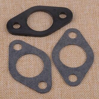

theoldwizard2 2 #1 Posted April 24, 2021 When I removed the carburetor from my 310-8 with a Kohler 241 engine the gasket/spacer tore badly. The parts manual says it is a 271030, but the images I have found for that gasket show one that is "standard" gasket thickness. The old on is about 1/4" thick ! More a space/insulator than just a gasket. Is that the correct part number ? Better solution ? Share this post Link to post Share on other sites
theoldwizard2 2 #2 Posted April 24, 2021 I found this on eBay 3 pack Carburetor Gasket Fit for K series Share this post Link to post Share on other sites
rmaynard 16,869 #3 Posted April 24, 2021 (edited) I had two B-100's. One of the K-241 engine/carburetor had a thick spacer, and one had a thin gasket. I've swapped them with no difference. Don't know what the significance of the thick one is. Maybe it was a clearance thing. Checking with Isavetractors.com he says it's to insulate the carburetor from the hot engine. Go figure. Edited April 24, 2021 by rmaynard 1 Share this post Link to post Share on other sites
squonk 45,535 #4 Posted April 24, 2021 Thick gasket is an insulator to keep heat away from the carb in certain applications. Of course with that muffler right there, a lot of good it will do! 1 Share this post Link to post Share on other sites
Howie 900 #5 Posted April 25, 2021 You cxan scrape the gasket off each side of the thicker one and use the gaskets shown. The middle of most of those is plastic or something like that. Share this post Link to post Share on other sites
theoldwizard2 2 #6 Posted April 25, 2021 (edited) 18 hours ago, rmaynard said: I had two B-100's. One of the K-241 engine/carburetor had a thick spacer, and one had a thin gasket. I've swapped them with no difference. Don't know what the significance of the thick one is. Good to know ! 18 hours ago, rmaynard said: Checking with Isavetractors.com he says it's to insulate the carburetor from the hot engine. Very common on air cooled engines ! Edited April 25, 2021 by theoldwizard2 Share this post Link to post Share on other sites
