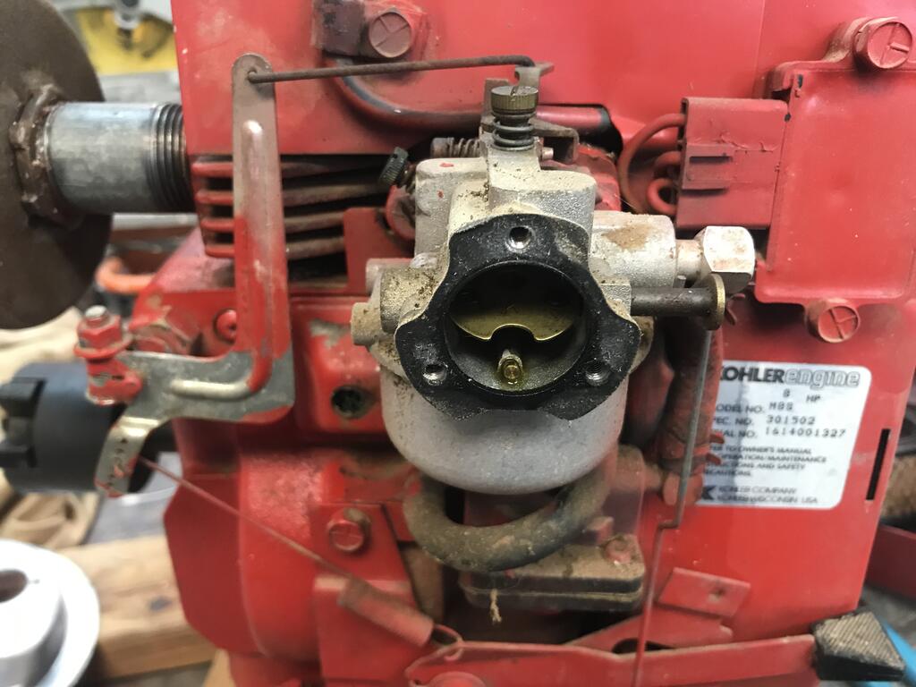

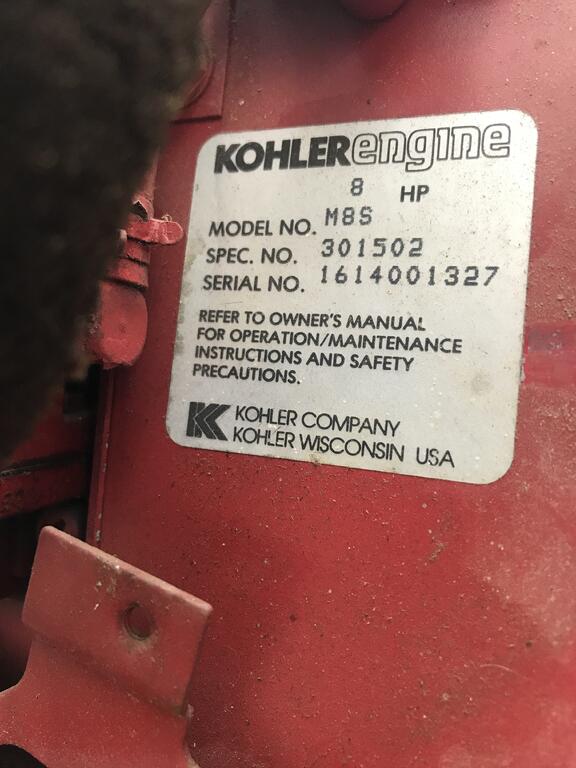

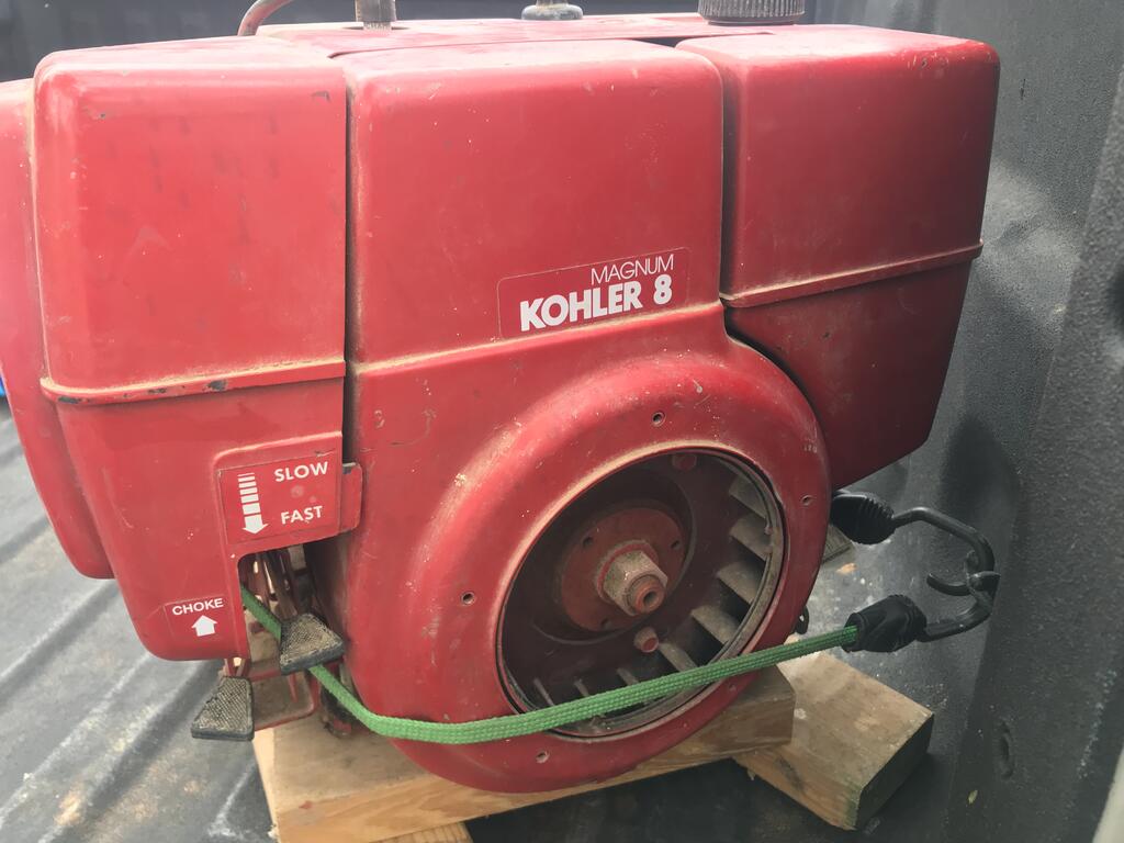

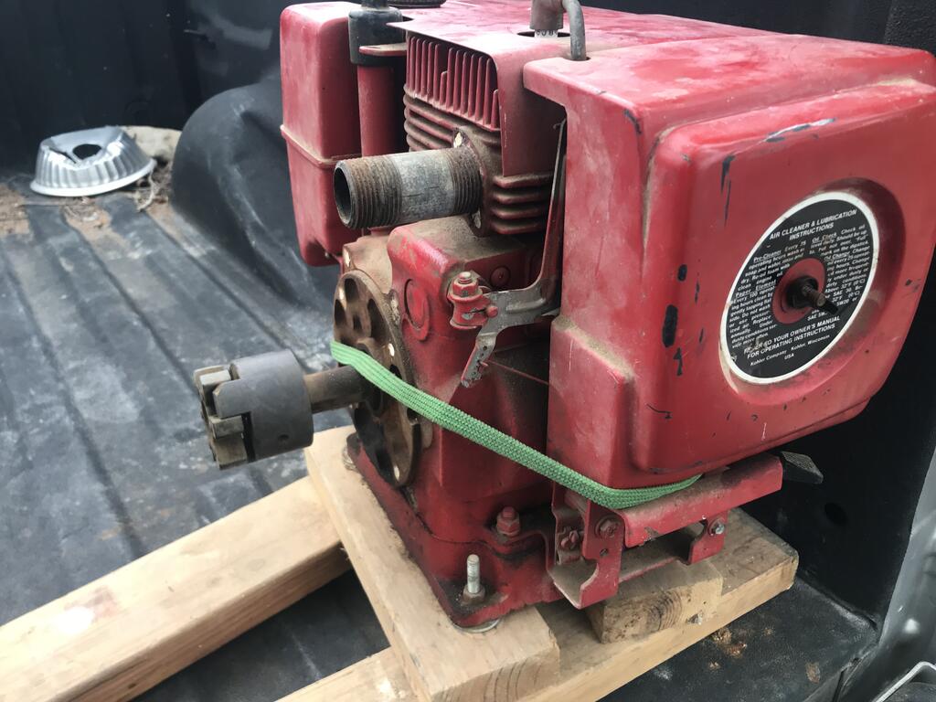

oliver2-44 11,390 #1 Posted April 23, 2021 (edited) So this has been on Clist for quite a while, gradually reducing in price. I looked at it, made an offer that was refused, but I left my number. He called and said come get it this morning. He said he bough it years ago as a replacement engine for a grain elevator on his farm. Old Kohler on the grain elevator just kept running till he sold the farm and moved near here to retire. He said he started it once, then drained the gas years ago. Many things look NOS, the spark plug still has factory red paint on it, the paint hasn't even darkened around the exhaust and the nipple screwed into the exhaust has rusty threads, but was just a little more than hand tight. The Spec# list it as a Basic 8HP Engine, and the Serial Number comes up as a 1986 I want to put some new fuel hose on it. Then hopefully I'll get to see if it will run this weekend, wish me luck. Edited April 23, 2021 by oliver2-44 7 1 Share this post Link to post Share on other sites

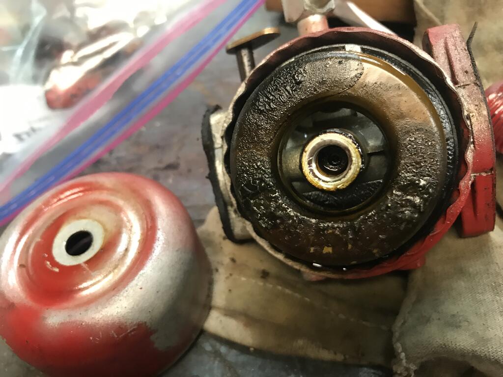

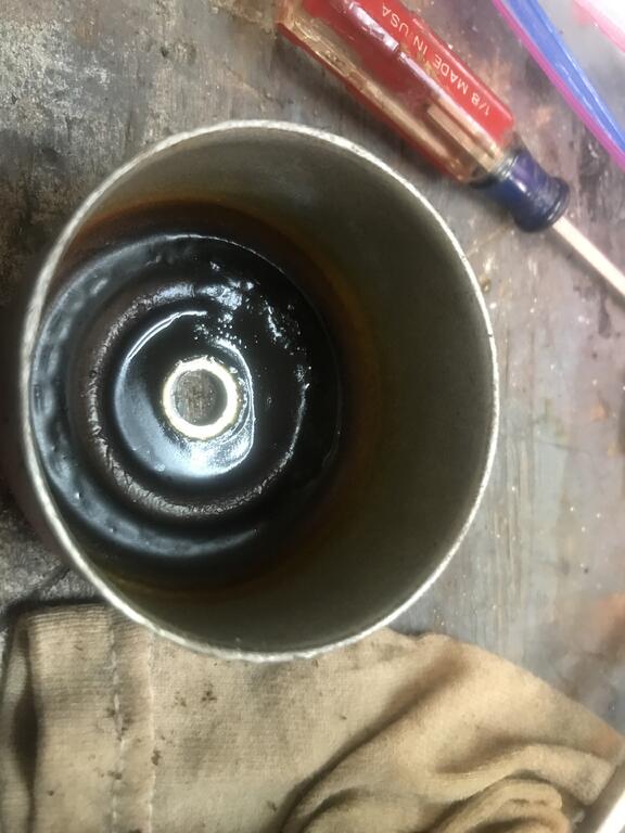

oliver2-44 11,390 #9 Posted April 23, 2021 (edited) Yes, it’s electric start I gassed it up with 2 cycle gas, put a squirt of oil in the cylinder and spin it over with the plug wire off. It started dumping gas out the carb telling me float was stuck. I shut the gas almost off and it fired up for a few seconds, then flooded Pulled the carb and the float was stuck down to the goo in the bowl. Had to soak it in carb cleaner to even get bowl off. It will soak in cleaner for a day or two. Edited April 23, 2021 by oliver2-44 Share this post Link to post Share on other sites
