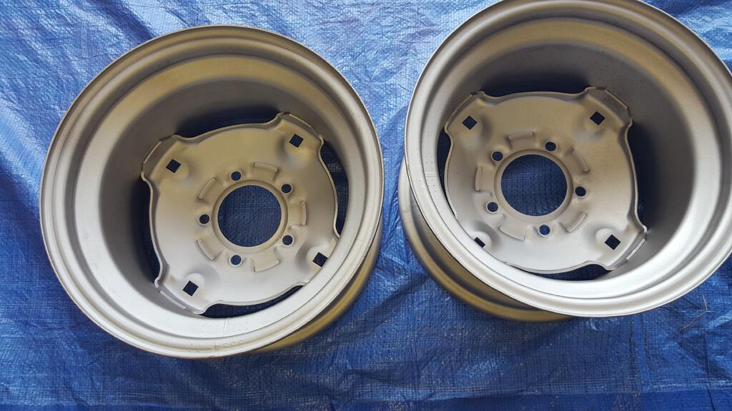

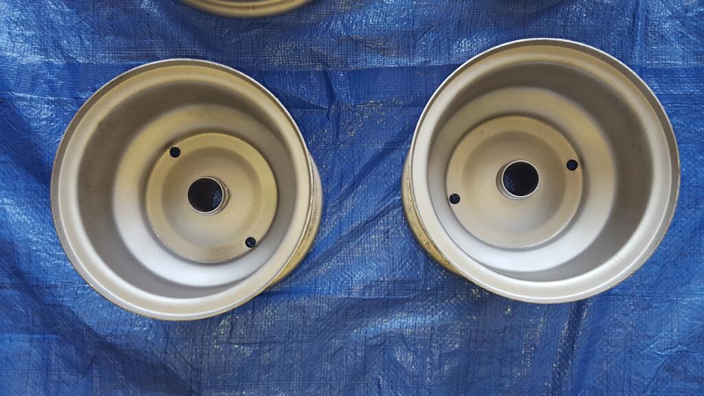

Gregor 4,847 #1 Posted April 22, 2021 I got some parts back from the media blaster today. They sure clean up nice. Wipe them with a little mineral spirits, and they are ready to paint. I have no plans for these wheels right now, so they will just get primer. 5 Share this post Link to post Share on other sites

Gregor 4,847 #4 Posted April 22, 2021 37 minutes ago, pacer said: I sure would hate to do without my blast cabinet I would love to have one, if I had the space. But if I had the space, I would probably buy another tractor to put in that pace, and then I wouldn't have the space anymore. It's a vicious cycle. 3 Share this post Link to post Share on other sites

haydendavid380 759 #9 Posted April 23, 2021 Man those look good. I've been doing my best this week trying to re-do a couple. Wire wheeling and hand sanding.... media blasting is the way to go. Share this post Link to post Share on other sites
