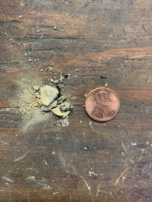

Gregor 4,847 #1 Posted April 19, 2021 (edited) I found this posted on another forum. Never heard of it before, but there are lot's of things I've never heard of. This is a condensed version. It's a Honda generator. It is a eu2000i. It starts and runs for one second and dies every time. It has gas, spark, and compression. So far Ive changed carburetor, fuel pump, and rectifier. Ive also checked compression release, oil level sensor, piston and rings, cylinder wall, and adjusted valves. Everything checked out good. It almost seems like it floods itself out. Any help would be greatly appreciated. He did manage to get it fixed. Any guessers out there before I edit and post the final findings, in 5 minutes? OK A little more . As I said before it would start and run for one second and die. What I didn't pay any attention to was what it did when it died. It would jump around on the bench, and then would be very hard to pull the rope. I noticed that if I pulled the rope slowly it would release compression out of the carburetor, then it would be easy to pull and start. Again it would run for one second and die. Then it hit me! Why was their that amount of pressure in the cylinder? Were the exhaust gasses getting out? I tried again, and this time once it started, I put my hand over the exhaust, and didn't seem to feel anything. I tried again, this time I stuck my finger in the exhaust and plugged it completely. There was absolutely no pressure! I took the muffler off, pulled the rope and BINGO!! She fired right up and purred like a kitten! Makes me wonder about the motor on my C125 A It does pretty much the same thing. Have not messed with it yet. Edited April 19, 2021 by Gregor 2 Share this post Link to post Share on other sites

Achto 31,017 #3 Posted April 19, 2021 (edited) 1 hour ago, Gregor said: There was absolutely no pressure! I took the muffler off, pulled the rope and BINGO!! She fired right up and purred like a kitten! These small inverter generators that do not run wide open (3600 rpms) all of the time have an issue with the muffler or the spark arrestor plugging up with carbon. His findings are not real surprising to me. 1 hour ago, Gregor said: Makes me wonder about the motor on my C125 A It does pretty much the same thing. Have not messed with it yet. If your exhaust is plugged it will not run. I have not heard of this happening on a garden tractor, but it is possible. Edited April 19, 2021 by Achto 3 Share this post Link to post Share on other sites
Gregor 4,847 #4 Posted April 22, 2021 (edited) Follow up on generator that would not run. Wasp nest!!! I cut it apart (the muffler)and found a little wasp nest in the exhaust pipe! Just enough to plug it up. Thanks again for all the replies. Its been a fun little project. Edited April 22, 2021 by Gregor 1 Share this post Link to post Share on other sites
