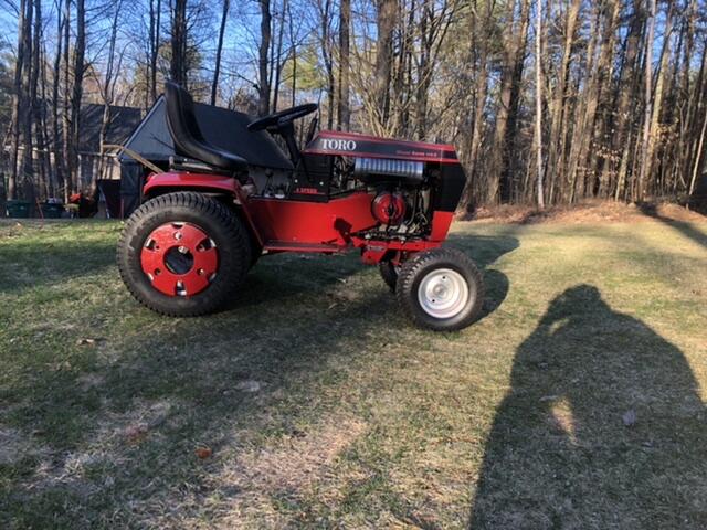

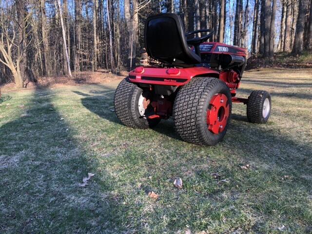

WheelhorseBob 1,550 #1 Posted April 18, 2021 They make the rocking world go round! got the 24-12-12 Carlisles mounted with a set of Farmall weights on her. I really like the way they look on this tractor. I think the added stability will be good when I get the loader on as well. For perspective, the 23-10.5-12 Deestones. 7 7 1 Share this post Link to post Share on other sites
roadapples 6,983 #2 Posted April 18, 2021 What width wheels did you use... 1 Share this post Link to post Share on other sites
WheelhorseBob 1,550 #3 Posted April 18, 2021 12 minutes ago, roadapples said: What width wheels did you use... 8.5 520 rims. Share this post Link to post Share on other sites
roadapples 6,983 #4 Posted April 19, 2021 They look great. I'm surprised the tread isn't bulged up... 1 Share this post Link to post Share on other sites
WheelhorseBob 1,550 #5 Posted April 19, 2021 34 minutes ago, roadapples said: They look great. I'm surprised the tread isn't bulged up... Honestly they aren’t all that much wider than the stock 520 Dico’s, maybe 1”.And they don’t seem any taller Share this post Link to post Share on other sites
WHX?? 51,885 #6 Posted April 19, 2021 I like it Bob but you are mentioning a FEL going on? Them weights look like they grew there! 1 Share this post Link to post Share on other sites
WheelhorseBob 1,550 #7 Posted April 19, 2021 9 minutes ago, WHX24 said: I like it Bob but you are mentioning a FEL going on? Them weights look like they grew there! Yes ‘this tractor has a very nice Kwikway loader and was the reason for all the upgrades like the swept front axle and fatty tires. It will be on in the next couple of weeks. 1 Share this post Link to post Share on other sites
seuadr 489 #8 Posted April 19, 2021 those off a farmall A? those weights are SLICK Share this post Link to post Share on other sites
WheelhorseBob 1,550 #9 Posted April 19, 2021 42 minutes ago, seuadr said: those off a farmall A? those weights are SLICK Yes I believe they are for A’s and several others. Thanks to a forum member for letting me know they would fit. They have to go to the outside however. The hole isn’t big enough for the Hub to pass through. Share this post Link to post Share on other sites

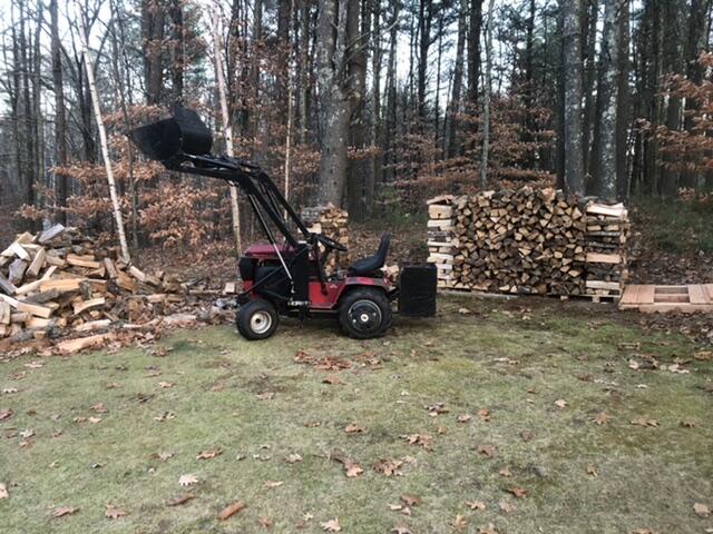

roadapples 6,983 #10 Posted April 19, 2021 You'll need about 250lbs more weight, ballast, for a loader... 2 1 Share this post Link to post Share on other sites
WheelhorseBob 1,550 #11 Posted April 19, 2021 1 hour ago, roadapples said: You'll need about 250lbs more weight, ballast, for a loader... My tractor has the ballast box which mounts to the rear hitch and sub frame. I might just get the tires filled with beet juice too. Pic before I updated the front end and did a hasty restore. 2 Share this post Link to post Share on other sites

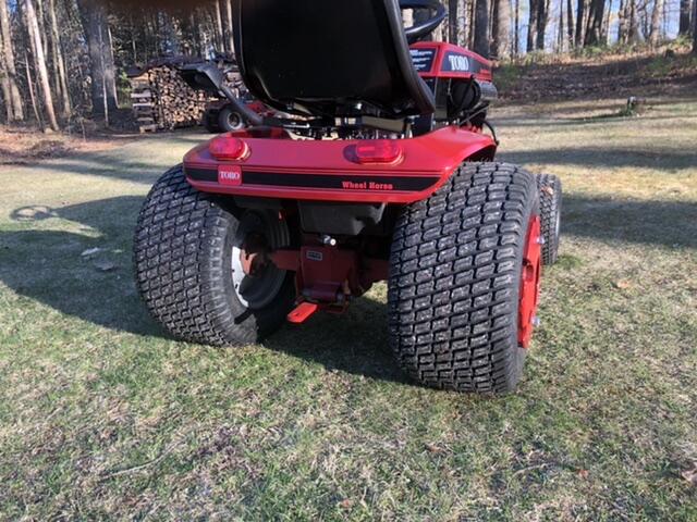

mrc 960 #12 Posted April 20, 2021 tires look great! for that matter the entire tractor looks great! i went to TSC and found the carlisle tires you mentioned . for years i have bought carlisle tires. for years they always said MADE IN U.S.A. at TSC the 24x12x12 said made in CHINA. i passed. i am so disappointed in carlisle. best regards mike in mass. 1 Share this post Link to post Share on other sites
WheelhorseBob 1,550 #13 Posted April 21, 2021 I honestly didn't look at that. I'll look tonight. 22 hours ago, mrc said: tires look great! for that matter the entire tractor looks great! i went to TSC and found the carlisle tires you mentioned . for years i have bought carlisle tires. for years they always said MADE IN U.S.A. at TSC the 24x12x12 said made in CHINA. i passed. i am so disappointed in carlisle. best regards mike in mass. Share this post Link to post Share on other sites
Turftech 82 #14 Posted April 21, 2021 Yes the Carlisle tires we buy for the golf course have small made in China stampings on the inside of the tire casing. The easy way to tell with China tires MFG since late last year, the tire size is now in English & metric on the side wall. Share this post Link to post Share on other sites
