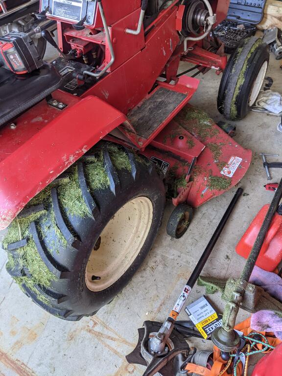

atbinkowski 13 #12 Posted April 18, 2021 Jeff - that's the first time I've seen that size listed, so that good to know. All information on the web (and this forum that I've found) lists the size I mention. Tuneup- I've attached a picture of the wheel on my C175. With the deck up there isn't much of an issue. With it down, and set to the cut height I want, the deck wheels will rub against the rear tires for certain, and will rub at times just going straight. They are excellent for plowing though. The deck is raised in the picture. Share this post Link to post Share on other sites
Jeff-C175 7,206 #13 Posted April 18, 2021 (edited) 1 hour ago, atbinkowski said: attached a picture If those are 10.50 then it's a good bet that the wheels are not stock either. The sidewalls would have more angle to them on a stock 7" wheel. Also, the valve stems on the outside is another 'tell'. The stock wheels had the valve stem on the inside. Those may be 9" wide rims from ? somewhere else. Even though the WIDTH of the tire is listed as 10.50, it has been demonstrated time and again that the HEIGHT is not set in stone. The same size tire from different manufacturers can vary in height quite a lot. I believe what I might do in your situation is to find a set of stock rims and fit either 8.50 or at most 9.50 on them and install turf tires for mowing. Check with Lincoln at AZ TRACTORS for the wheels. I just bought a pair in VERY good condition for a very reasonable price. Use the AGS in the winter for plowing and the turfs in the summer for mowing. Edited April 18, 2021 by Jeff-C175 Share this post Link to post Share on other sites

atbinkowski 13 #18 Posted April 18, 2021 The rims are 9.50 bought a pair 22x9.50-12 turf tires and put them on today (only took one pry bar to the face, but I still won the battle). They should work. Still the possibility of a very very slight rub. I might see about moving the attach-o-matic mount forward one hole, but then the front tires might hit it. We'll see what happens next time I mow...of course in Ohio, we're expecting snow this week...smh... Share this post Link to post Share on other sites
