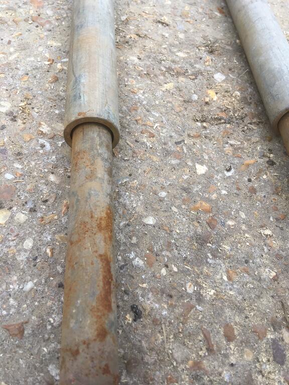

ranger 1,828 #8 Posted April 16, 2021 I picked up a number of poles around that size from a sale, they are the supports for the folding / sliding “curtains” used on truck and semi trailer “curtain siders” sides. They have a spring loaded bar inside one end to allow for removal. They are around eight or so feet long and thick walled. Do you have the same things on your trucks in the USA? Perhaps there is a local truck breakers yard you could contact/visit? Doug. 1 Share this post Link to post Share on other sites

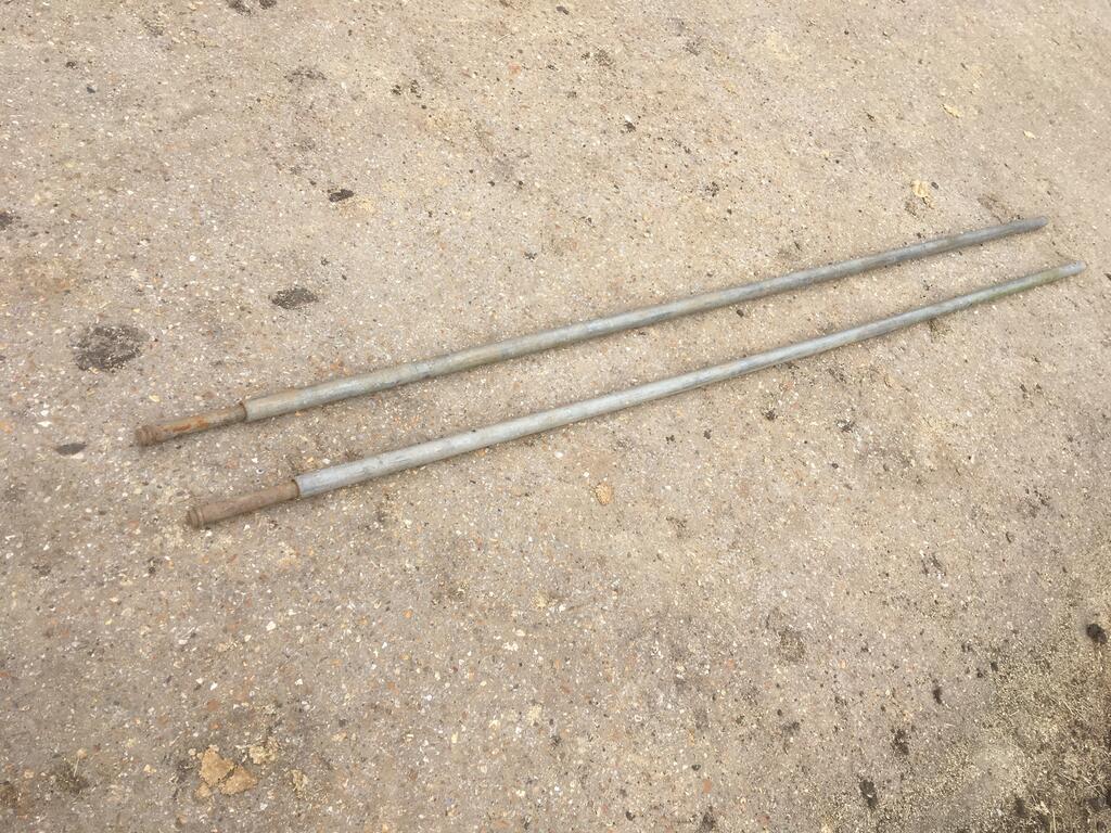

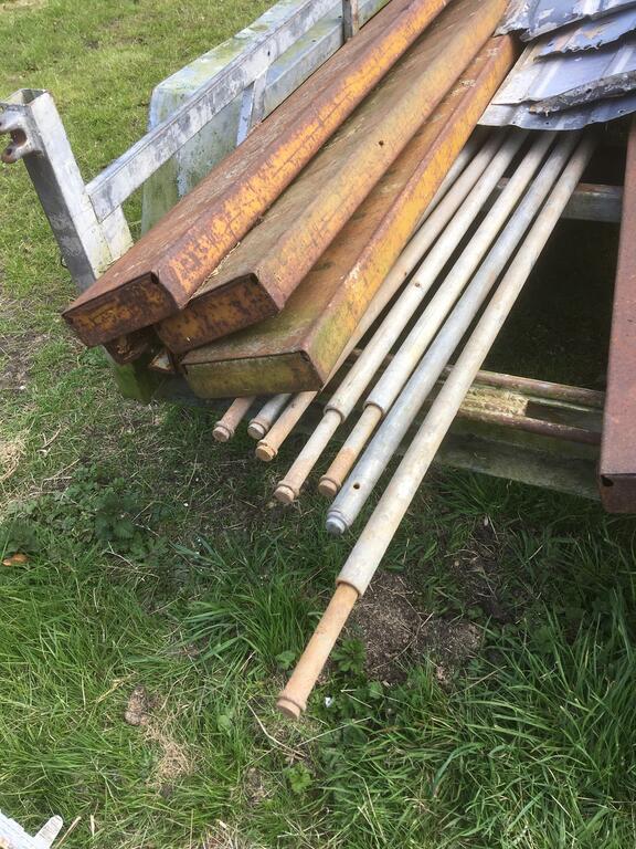

ranger 1,828 #15 Posted April 16, 2021 A few pics of the pipes I mentioned in my earlier post. 1 1 Share this post Link to post Share on other sites
