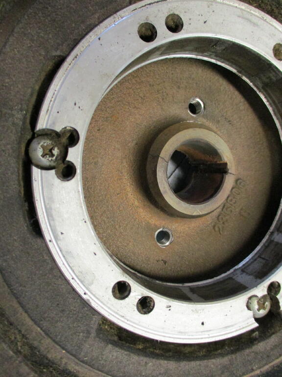

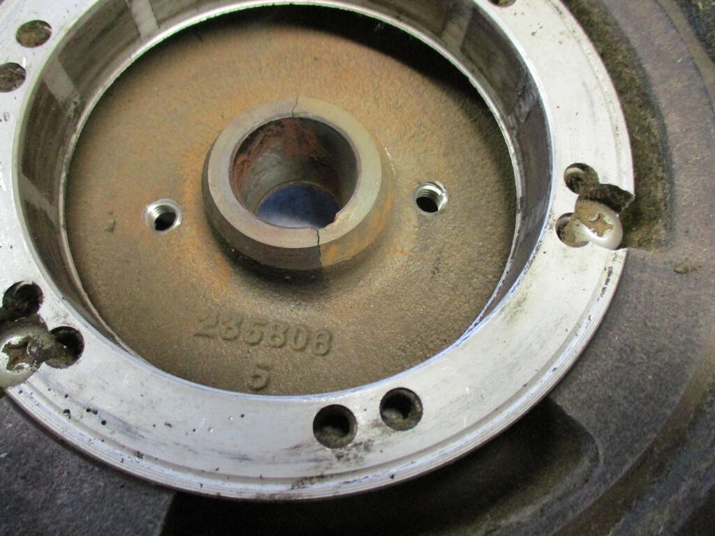

pfrederi 19,497 #1 Posted April 14, 2021 actually dodged flying flywheel pieces. Picked up an Electro a couple years ago. I pulled the head when I got it to decarbon and saw it was .030 over. OK no problem she ran well no smoke. Loaned her to neighbor who used her 48" deck to mow a couple acres for 2 years. Ran fine but leaked like a sieve. he bought fancy new Kubota 2601 and returned the horse . i used her last winter for limited snowplow duty. Got tired of the leaks and tore her down. Cause of eh leaks was pretty obvious, who ever did the overhaul didn't want to spring for a gasket set. Some were obviously reused and in poor shape some no gaskets at all just some RTV especial the oil and fuel pump. Also noted the flywheel didn't have a normal bolt holding it on. Started to reassemble and when I cleaned up the flywheel to put it back on saw this..... 2 1 1 4 Share this post Link to post Share on other sites

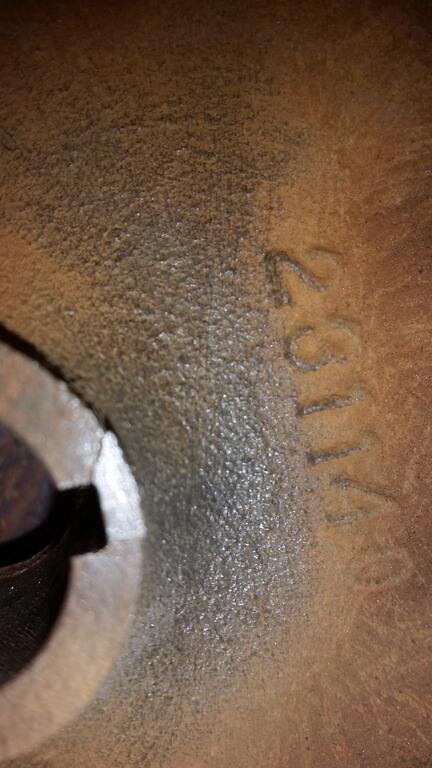

WHX?? 53,762 #2 Posted April 14, 2021 (edited) Yep been there Paul.. twice in fact on a K161 that I got from Kev and the flywheel on the original motor. We all guessed it was from improper key installation or using an impact on the nut or both. Lucked out and found one reasonably priced on fleabay. Edited April 14, 2021 by WHX24 3 Share this post Link to post Share on other sites
pfrederi 19,497 #3 Posted April 14, 2021 I agree on the impact wrench...Had a real struggle getting the flywheel off, obviously over tightened... 2 Share this post Link to post Share on other sites
Kenneth R Cluley 654 #4 Posted April 14, 2021 That's not just a bullet, more like a hand grenade! People don't realize the damage they can cause with impact. Torque specs are there for a reason. Lucky catch. 6 Share this post Link to post Share on other sites
953 nut 63,575 #5 Posted April 14, 2021 Probably caused by some shade-tree mechanic using a BFH tool rather than a puller to remove the flywheel. 1 Share this post Link to post Share on other sites
JoeM 9,391 #6 Posted April 14, 2021 I figure your spot on with the impact. I have seen people put grease on that fit hoping it will come off easy but allows over tightening. I clean up with a scuff pad and put it together. Share this post Link to post Share on other sites
953 nut 63,575 #7 Posted April 14, 2021 5 minutes ago, JoeM said: I have seen people put grease on that fit hoping it will come off easy but allows over tightening. I clean up with a scuff pad and put it together. If people were to read the Kohler manual they would know that is a no-no. 1 Share this post Link to post Share on other sites
