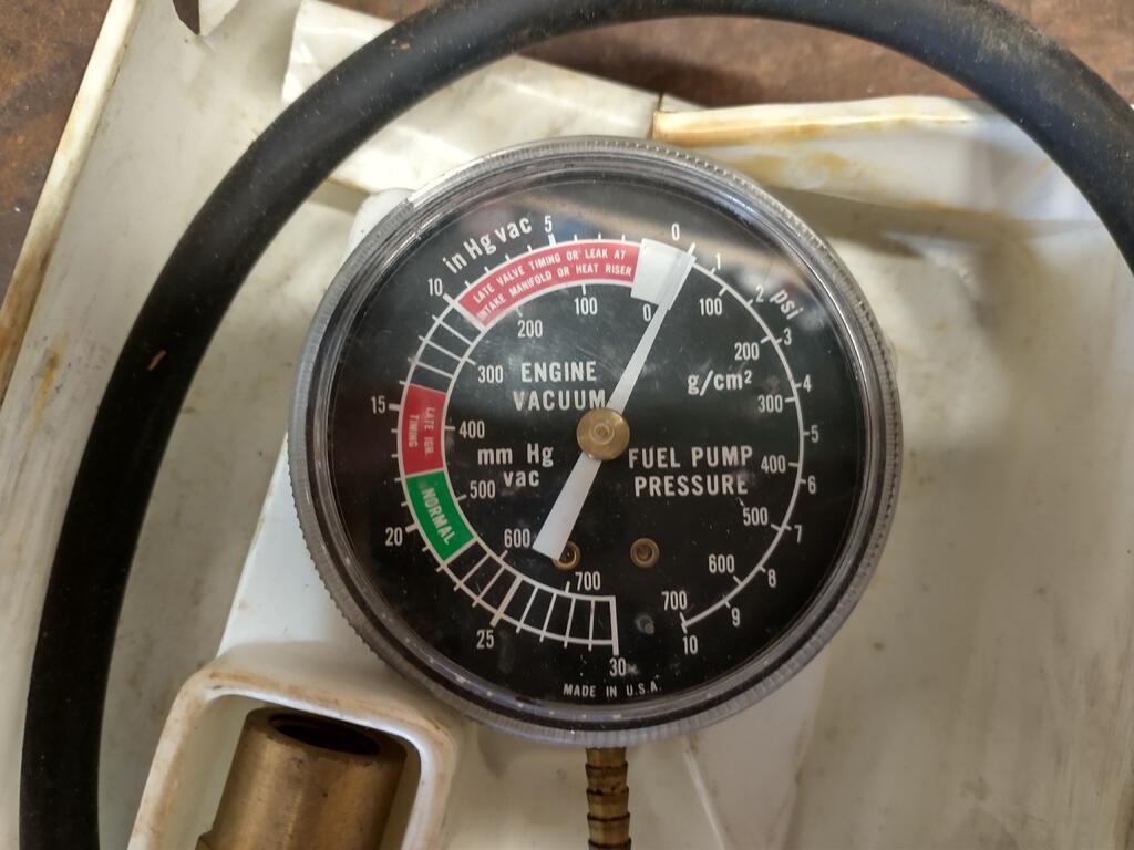

squonk 45,492 #4 Posted April 14, 2021 (edited) 19 minutes ago, Achto said: Personally I really never saw a big value in the vacuum / power gauge. I was always taught that there are only 2 gauges that really matter on an engine. Oil pressure and water temperature. All other gauges are only there for convenience. Not so!! I remember riding in my Uncle's 65 Impala SS with the big honkin vacuum gauge on the dash. I could have watched that thing all day! In all seriousness , the Toro gauge may not be the most useful one , but I diagnosed many an 8 cylinder engine with a hand held vacuum gauge. " late timing, sticky valves,bad cams ect. Still in the tool box! Edited April 14, 2021 by squonk 2 2 Share this post Link to post Share on other sites

squonk 45,492 #11 Posted April 14, 2021 Yes. Setting idle mixture you would want to obtain the highest reading with no flutter or hunting back and forth. Flutter/ bouncing would indicate a valve not sealing good for example. Hunting up and down- lean mixture. Low reading late timing 3 2 Share this post Link to post Share on other sites

squonk 45,492 #15 Posted April 15, 2021 Ol' Reliable. Had to get it out of the toolbox just to look at it again in all it's glory! 4 1 1 Share this post Link to post Share on other sites
