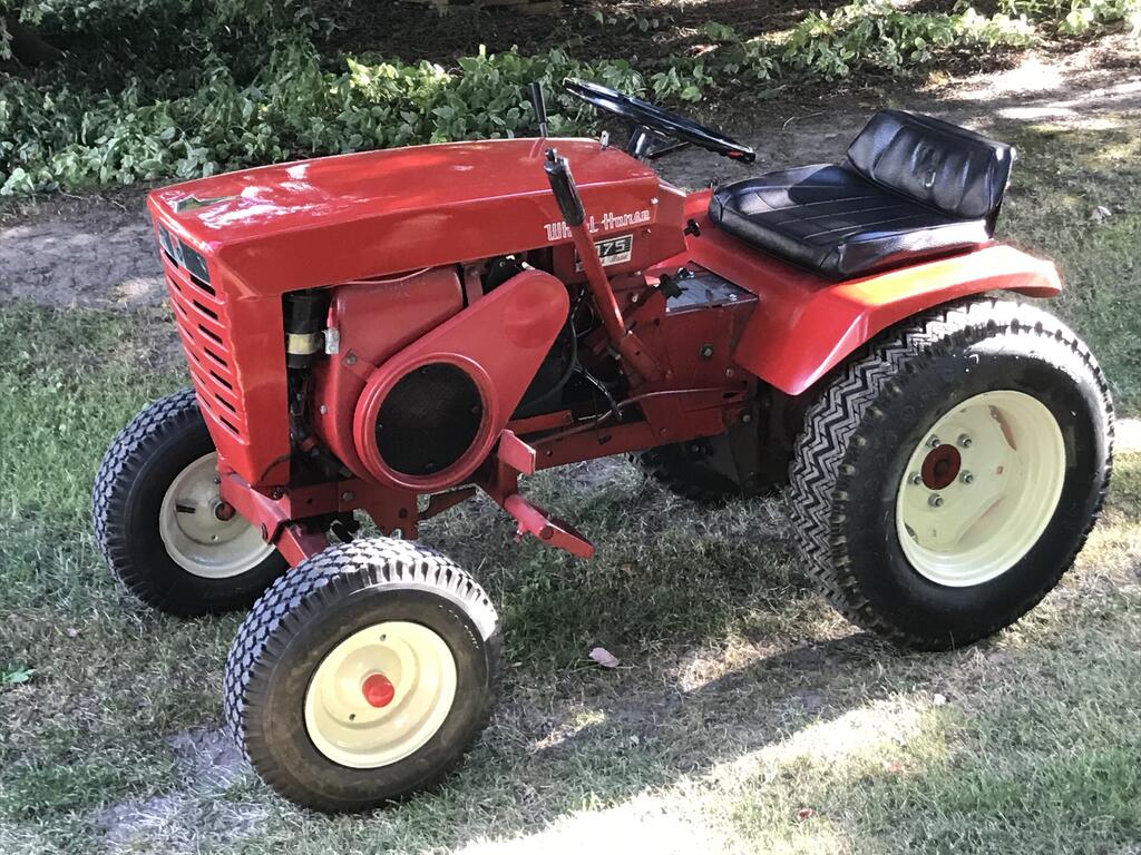

Kennyb 4 #1 Posted April 12, 2021 Hi folks I'm new here and to collecting horses,I have a 68 electo 12,and a 78ish b111,and now I just bought a 875 wheel a matic with no engine,I bought a 14 horse kohler but is way to big,what size is called for this machine,any help would be much appreciated,ty 1 Share this post Link to post Share on other sites
squonk 44,625 #2 Posted April 12, 2021 (edited) 8 HP Kohler Edited April 12, 2021 by squonk 3 Share this post Link to post Share on other sites
WHX?? 52,901 #3 Posted April 12, 2021 (edited) Kenny A 8 HP would be correct but there ain't a person here who fault you from say a 7 HP K161. Squonk's a faster typer but also appears he left his welcome manners in the top drawer today! BTW you might be able to squeeze a K241 in there with a short base like a 1045 or a 1055. Edited April 12, 2021 by WHX24 3 Share this post Link to post Share on other sites
Achto 29,851 #5 Posted April 13, 2021 Looks like the group has you covered. 8hp Kohler K181 would be the correct engine for an 875 2 Share this post Link to post Share on other sites

Kennyb 4 #8 Posted April 13, 2021 Thank you all, beautiful tractors btw,I'm glad I found this site, unfortunately if I try to mount the 14 horse the hood would have to be raised and I would like to make it as original as possible,any input on a 8 horse near northern Michigan? There a little tricky To find Share this post Link to post Share on other sites

953 nut 62,174 #14 Posted April 13, 2021 As you can see in Jim's @WHX24 picture the 10/12 HP engines that will fit under your hood are a lower oil pan engine. One option you may want to consider would be fabricating a front hood hinge that will raise it enough to clear the 14 HP engine and make a short riser to elevate the dash tower enough for the hood to rest properly. Share this post Link to post Share on other sites
