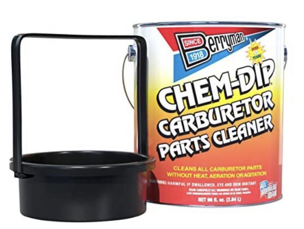

The Tuul Crib 7,340 #9 Posted April 12, 2021 I use this to soak em down. Then the ultra sonic cleaner. 2 Share this post Link to post Share on other sites
RJ Hamner 1,025 #10 Posted April 12, 2021 Just now, The Tuul Crib said: I use this to soak em down. Then the ultra sonic cleaner. I use the NAPA version 1 Share this post Link to post Share on other sites
The Tuul Crib 7,340 #11 Posted April 12, 2021 Good stuff!! Sure does stink!! Share this post Link to post Share on other sites
