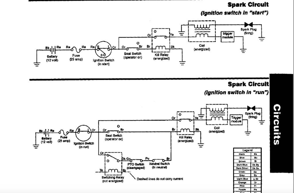

seuadr 489 #1 Posted April 11, 2021 So, i got the new motor to fire over by bypassing straight to the coil, which means one of the safeties is out, or i have a bad relay. looking at the schematic: i'm wondering if the heat temp sensor provides ground to pin 12 of the idiot lights? looks like those fo all the way around to all of the relays and that sensor broke when i installed it (well, technically when i pulled the harness tight a few mins later..) my seat switch has been gone for i don't know how long, it was long gone when i got the tractor. the neutral switch seems to work - i show continuity when i close it in place, and none when i open it. i haven't gotten in to test the PTO switch, i can't actually get at it when the battery is in place - but i came in the house to take a look at the schematic and now i'm wondering if it is the head temp sensor - i initially thought it was just an indicator light? am i wrong? Share this post Link to post Share on other sites

Handy Don 16,062 #3 Posted April 11, 2021 (edited) This unit has the extra relay that "assembles" the inputs of the safety switches (Kill Relay on the diagram) to prevent current to the coil (running). Switch Relay on the diagram keeps current away from the Start relay (starting). To my knowledge, the indicators are only indicators and have no effect on the start/run--that's the point of the relays. Yeah, complicated! Edited April 11, 2021 by Handy Don 1 Share this post Link to post Share on other sites

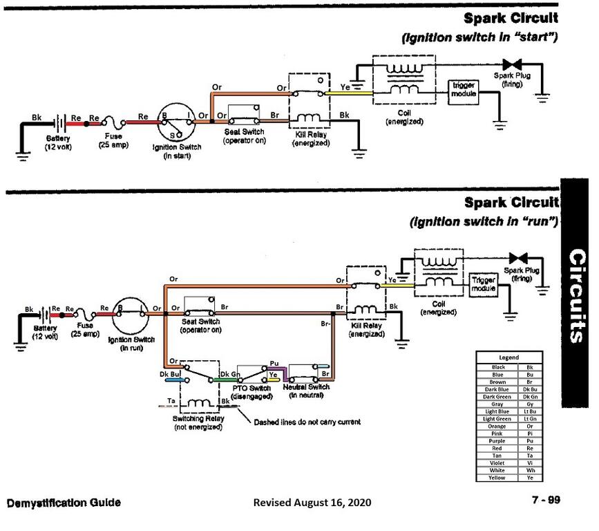

Chestnut 315 #4 Posted April 11, 2021 Wheel horse published a "demystification guide" - available on this forum, I think in manuals. It has a simplified wiring diagram that should help in tracking down the issue. I've attached the page for the '91-'97 520H. If I read it correctly when the switch is in start the current goes direct from the battery through the 25 amp fuse, the ignition switch, the seat switch (yours is bypassed), the kill relay, to the coil. Demystify 520H.pdf Share this post Link to post Share on other sites
seuadr 489 #5 Posted April 11, 2021 2 minutes ago, Chestnut said: Wheel horse published a "demystification guide" - available on this forum, I think in manuals. It has a simplified wiring diagram that should help in tracking down the issue. I've attached the page for the '91-'97 520H. If I read it correctly when the switch is in start the current goes direct from the battery through the 25 amp fuse, the ignition switch, the seat switch (yours is bypassed), the kill relay, to the coil. Demystify 520H.pdf 270.53 kB · 0 downloads Thanks, that is the guide i took the screenshot from. Looks like i need to test some switches, ultimately. Gotta rig up the battery to be hooked up temporarily outside the battery box to test the pto switch. I suspect that is the one, as it is pretty much the only one i have not tested. That said, while i know the seat switch is gone, I don't know where it was bypassed, so swapping motors may have disturbed that "fix" Share this post Link to post Share on other sites
Chestnut 315 #6 Posted April 11, 2021 2 minutes ago, seuadr said: Thanks, that is the guide i took the screenshot from. Looks like i need to test some switches, ultimately. Gotta rig up the battery to be hooked up temporarily outside the battery box to test the pto switch. I suspect that is the one, as it is pretty much the only one i have not tested. That said, while i know the seat switch is gone, I don't know where it was bypassed, so swapping motors may have disturbed that "fix" I couldn't get a full page screenshot of what I referenced, but it's a much-simplified diagram. 1 Share this post Link to post Share on other sites

seuadr 489 #9 Posted April 12, 2021 Thanks, the kill relay seems to not be closing, but the ground wire reads good to ground - I don't seem to have any voltage on the brown wire, which is why i was checking safeties. Found the seat switch bypass, appears to be good. Pto switch looked like it had bad connectors which i thought was the problem but nope. At this point i guess i just need to trace the voltage until it stops! 1 Share this post Link to post Share on other sites

Tractorhead 9,217 #11 Posted April 12, 2021 Check the Wire route where the Switching relay acts. get a Voltmeter and check all this points to ground. Voltage have to be checked in idle with disengaged pto and in neutral By switch ignition to on check between: port B on keyswitch to ground - there shall be Battery voltage be measured, if fail the 25A fuse or Fuseholder be suspected Keyswitch port I from orange wire to ground - if fail Keyswitch is suspect next is from orange wire on switch relay to ground = if fail wire somewhere interrupted cutted or defect ( broken). next is from dark green switching relay to ground if fail check the coil lines on this relay they must be both same level to ground if that is ok, the relay contacts be suspect. To test this you can also simply remove one of the coil wires from that relay, the relay will not switch. If the relay switches by reconnecting this wire, the coil path is somwhere wrong. - To continue test remove one of the both wires from relaycoil and try again, if no Next is from purple to ground if fail the PTO Switch is suspect next is at least brown to ground if fails check the Seatswitch it shall be shortened to test if all is ok with Seatswitch, engage a gear and than recheck between brown and ground, if fail the neutral switch is suspect. that is the basic test to find quick the antichrist in your Tractor. 1 Share this post Link to post Share on other sites
