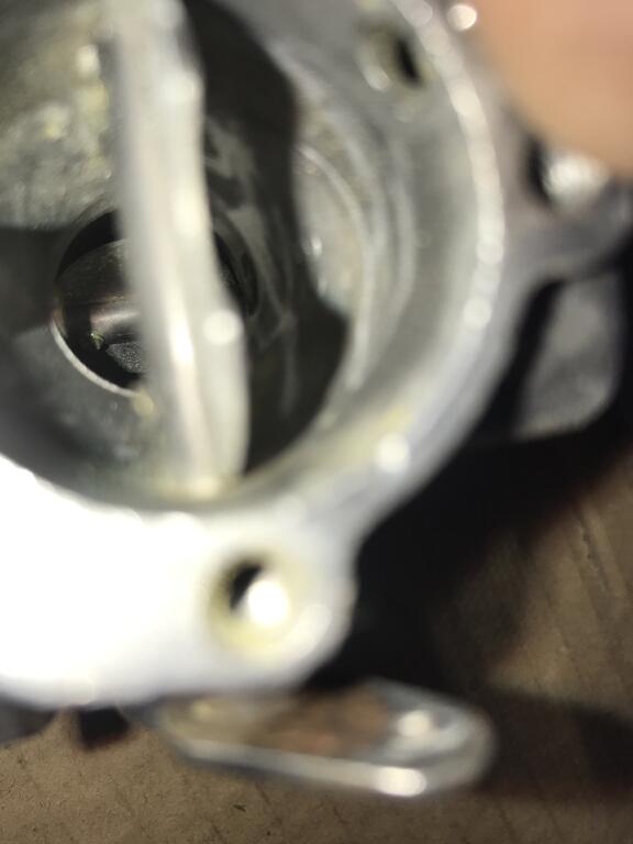

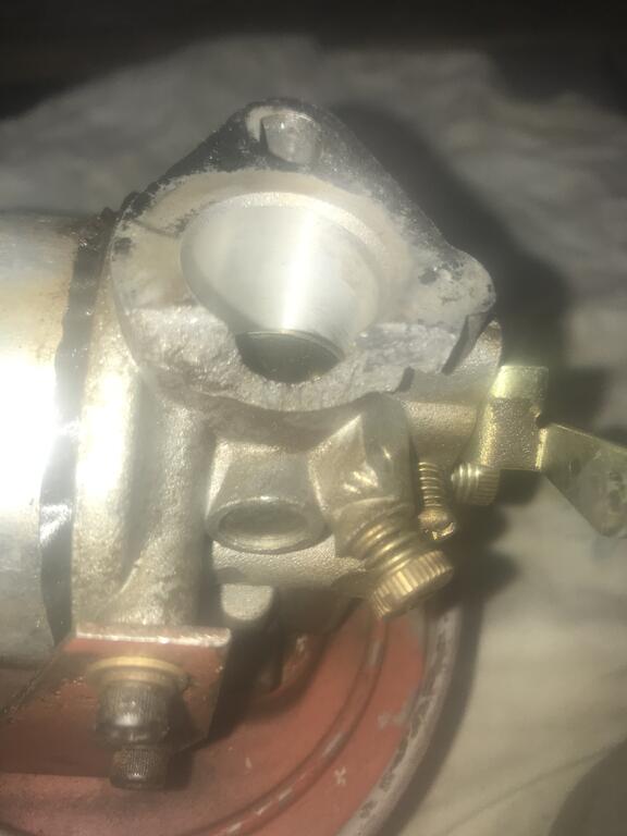

oliver2-44 11,214 #1 Posted April 11, 2021 (edited) I went to wake my C81 up from hibernation and no dice! It would turn over, had spark and would run good as long as I sprayed gas into carb, fuel pump pumped gas with hose disconnected. So time to pull carb and I found this. The other piece was still held in place by the nut, but there was about a 1/8" gap between the two. I imagine it was sucking too much air/gas through there to suck properly through the carb. On the right side of the break you can see a slightly darker gray area that may have been a flaw or early part of the break. The mounting nuts were not very tight so its hard to think I over tightened it this much. This is a aftermarket carb I put on it about two years ago as it came with no carb. I bought two at the time, the one for my case 12hp constantly flooded/junk and this one worked so/so but didn't have a lot of adjustment effect when the needles were moved full range in and out. So this failure leads to questions so I can learn more about Proper venturi size! As you may be aware the after market carbs are so where about 3 sizes fits all k series 4hp-16hp. I Looked through my various good and spare/parts engines carbs and this is what I have K91 4hp venturi #18 K141 6hp venturi #22 ?? K161 7hp venturi #20 ?? K181 8hp don't have K241 10hp dont have at home K301 12hp venturi #26 K321 14hp venturi #30 K341 16hp venturi #30 I did some googling and haven't found a Kohler chart listing hp/carb venturi size. So what size is the proper venturi (or what size venturi do you have on various K series engines. I especially need the proper venturi size for the K181. I'm thinikng of using the #22 off the parts K141 I have or buy a used one to rebuilt No more aftermarket carbs for me! Edited April 11, 2021 by oliver2-44 Share this post Link to post Share on other sites

oliver2-44 11,214 #8 Posted April 11, 2021 (edited) Thanks everyone some good documents you've shared. 4 hours ago, oldlineman said: I don't know why there seems to be so many carb problems. I have a 1979 c-101 ( bought new) with original carb never rebuilt only had to put new bushing on throttle shaft and a 1989 414-8 bought used about 20 years ago no carb troubles. Maybe I am just lucky but I do regular maintenance and use seafoam and corn free gas . Now that I brought this up probable have all kind of problems. Bob The carbs on my 312-8 and C160 have worked excellent for several years after I cleaned/rebuilt them when I got them. Each fall I run the gas off and run them dry. In the spring they start right up. I use ethanol free gas 60%+ of the time and do my best to put them away for the winter with ethanol free in them. Interestingly the Walmart and Bucky's that I buy from near the farm both were out of ethanal free gas for all of March and I have not been by there in April. There is a station/marina that sell it near me for double or more what I but it for near the farm. They also had no ethanol. my C81 and Case 180 both came without carbs is why I tried the aftermarket route. Edited April 11, 2021 by oliver2-44 1 Share this post Link to post Share on other sites
