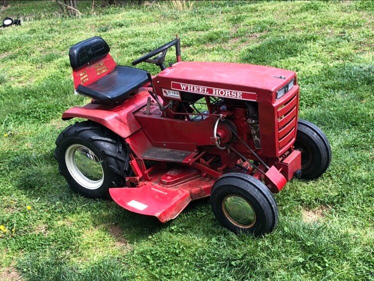

cat man 137 #1 Posted April 11, 2021 i bought my first WH its a C120 automatic its for cutting grass i put 4 new tires on it and a new head light lens and a good bath but id like to get a puller later on and wondered what WH tractor is used the most and why and are the standards best over an automatic 2 1 Share this post Link to post Share on other sites

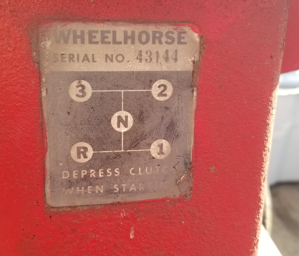

Jimdad85 12 #10 Posted September 21, 2021 (edited) I posted in the general topic forum and they suggested that i swing by here. I got this at an auction yesterday..i know it needs some work but was interested to know how well she would do as a puller. Any comments or advice would be appreciated. Also looking for a hood i guess. Im told its a 64 1054 c series. Thanks Edited September 21, 2021 by Jimdad85 Share this post Link to post Share on other sites

Wild Bill in VA 1,596 #12 Posted July 8, 2022 On 6/26/2022 at 10:55 AM, Docwheelhorse said: But.... it just seems appropriate... lol On 9/21/2021 at 8:42 AM, Jimdad85 said: I posted in the general topic forum and they suggested that i swing by here. I got this at an auction yesterday..i know it needs some work but was interested to know how well she would do as a puller. Any comments or advice would be appreciated. Also looking for a hood i guess. Im told its a 64 1054 c series. Thanks I posted in the general topic forum and they suggested that i swing by here. I got this at an auction yesterday..i know it needs some work but was interested to know how well she would do as a puller. Any comments or advice would be appreciated. Also looking for a hood i guess. Im told its a 64 1054 c series. Thanks The Unidrive in this model Wheel Horse used a spider gear type differential and would be very costly to replace (and hard to find) if broken. The axles were strong but unless you knew the history of the transmission ........... If I remember right there was a way to swap out a later 8 pinion. Wild Bill in Richmond VA Share this post Link to post Share on other sites
