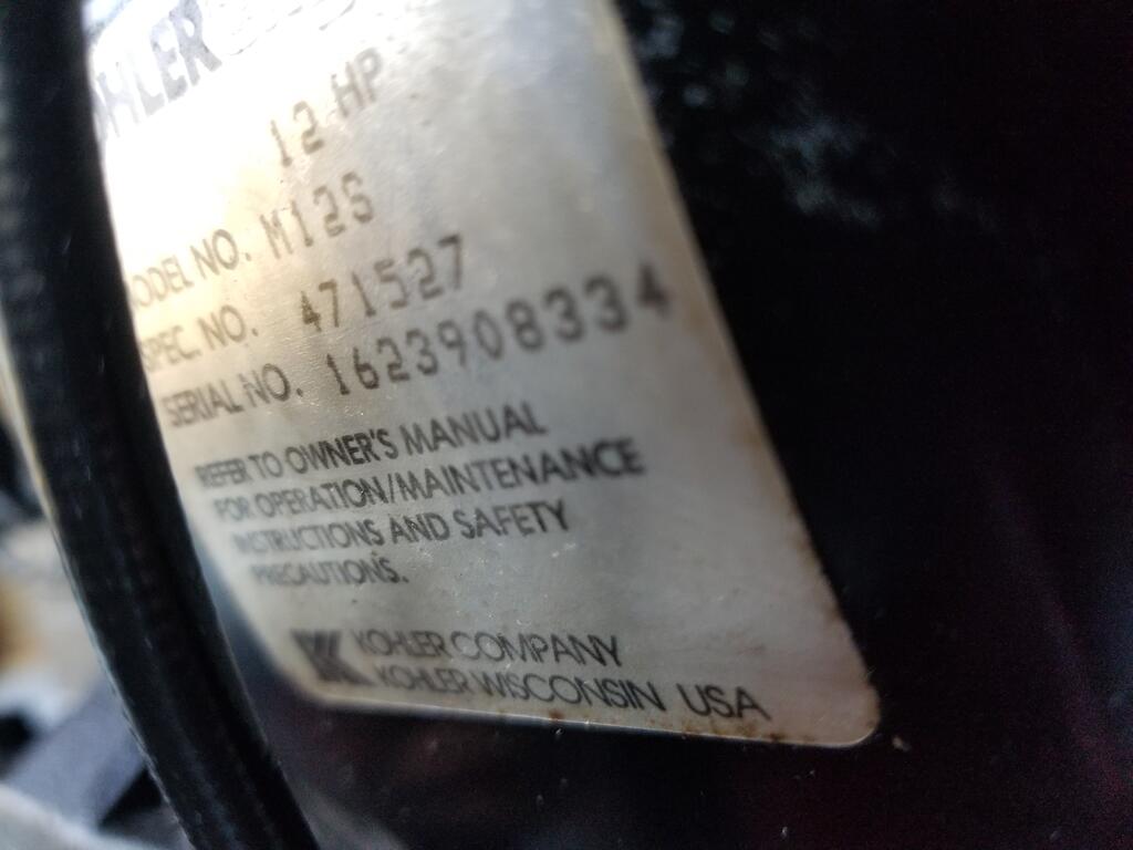

matt monte 232 #1 Posted April 9, 2021 at some point today (after 6pm) i lost carb linkage rendering my 312-8 useless. Can anyone help with a part number and pic? Share this post Link to post Share on other sites
gwest_ca-(File Mod) 12,000 #2 Posted April 9, 2021 https://www.partstree.com/models/m12-471527-kohler-magnum-engine-made-for-wheel-horse-12hp-9kw/ Garry 2 Share this post Link to post Share on other sites

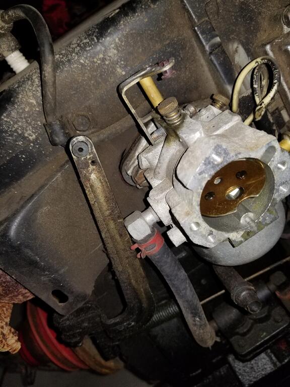

squonk 45,535 #3 Posted April 9, 2021 Not the best pic but the rod you need is in this picture: Share this post Link to post Share on other sites
