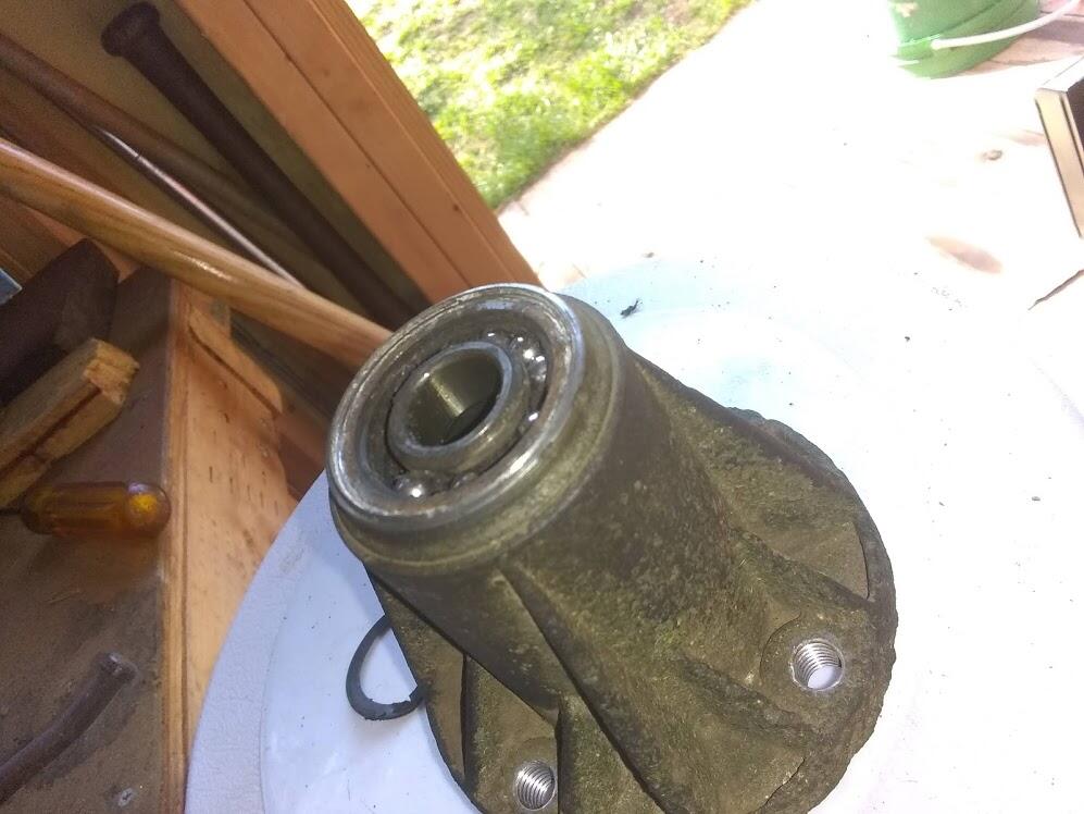

Jeff-C175 7,207 #1 Posted April 7, 2021 While performing autopsy on failed center spindle on a 48MS01 I had an interesting revelation. Note that the shoulders on the blade end of the spindle housing are tapered. They're supposed to be SQUARE! The one on the bottom was worn so thin that the groove for the snap ring broke out when I went to remove it. Take a look at all the CRUD in the spindle cup. That's grease, grass, and sand, maybe some rabbit blood for good measure. When that CRUD build up and gets packed in there it slowly grinds away at the shoulder of the housing. I am beginning to believe that part of routine maintenance should be to clean that crud out every couple years, if not every year. Those housings might last 60 years instead of only 40 ! I still haven't determined why the center housing pulley got wallowed out though... the bearings were fine! Share this post Link to post Share on other sites
Skwerl58 792 #2 Posted April 8, 2021 I pulled my center spindle on my 87 model last week and it was warn to the snap ring. The snap ring was still holding so I am replacing the bearings and using it as spare. 1 Share this post Link to post Share on other sites
Jeff-C175 7,207 #3 Posted April 8, 2021 (edited) 24 minutes ago, Skwerl58 said: warn to the snap ring The spindle cup full of crud like mine? ('80 model) I haven't disassembled the other two yet but a quick looK tells me they are in the same condition. I was going to rebuild them and sell, but they aren't worth doing that. Basically all I've got is two halfway decent shafts. Edited April 8, 2021 by Jeff-C175 Share this post Link to post Share on other sites
Skwerl58 792 #4 Posted April 8, 2021 I replaced another spindle two years ago with a new one that was not warn but a bolt hole was corroded away. The one I am replacing now did have some crud under the cup and also some type of twine in there too. I wouldnt sell the one I am repairing but will save for my use. Good used parts are hard to find in my area but I have picked up stuff from vendors and individuals on this site. 1 Share this post Link to post Share on other sites
Jeff-C175 7,207 #5 Posted April 8, 2021 12 minutes ago, Skwerl58 said: some type of twine in there All three of mine had bits of what looked like nylon string wrapped around them. Could have been in there for decades! I look at it as an additional 'seal' ! That housing looks OK, but that bearing sure is toast, ain't it? Share this post Link to post Share on other sites
