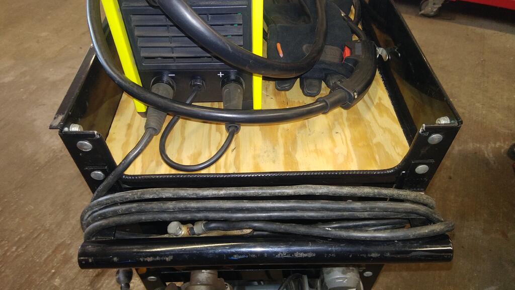

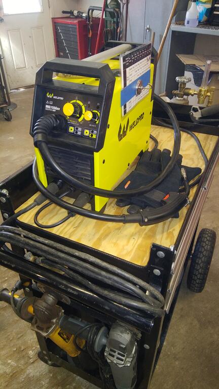

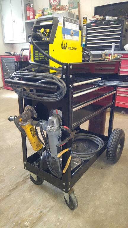

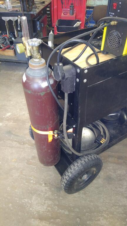

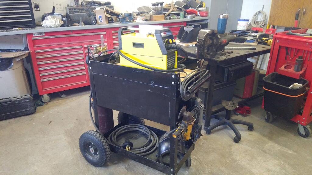

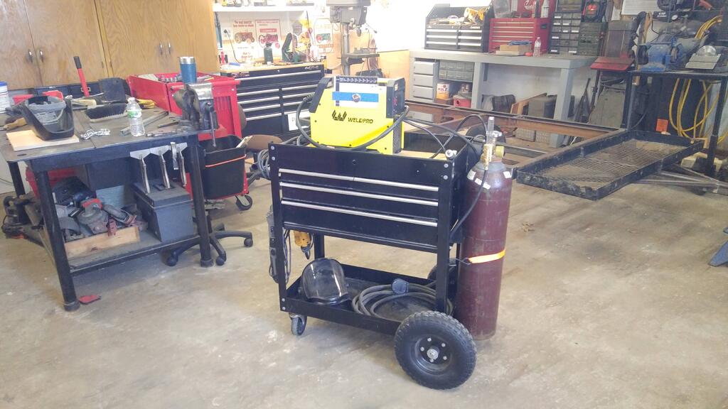

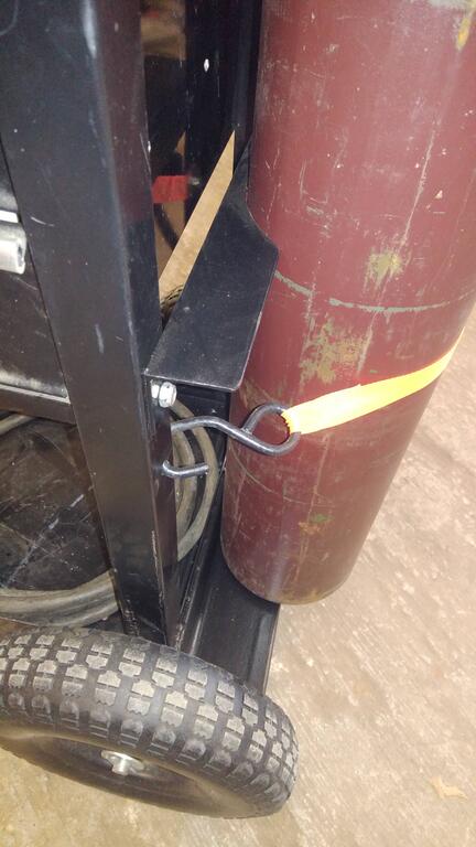

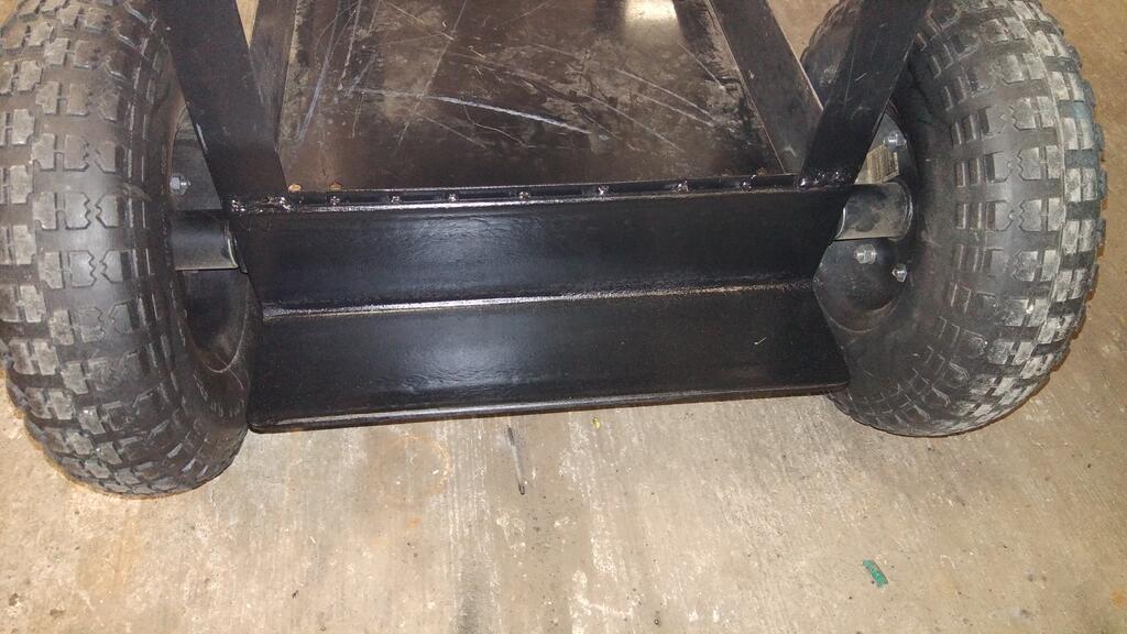

RandyLittrell 3,943 #1 Posted April 5, 2021 I ended up with a HF tool cart I wasn't using and my other welder cart/table wasn't really working out like I wanted, so I converted my tool cart to a weld cart. First I removed the lid and a divider on the left side along with the locking setup. I cut one end down between the uprights for connections for the welder. Covered the edges with some welting from amazon. I used 13" no flat tires from HF and the axle lines up with the bottom holes on the cart, just opened them up to 5/8" and slide the axle in and weld. I will let pictures speak for themselves and ask any questions you may have. It is working out really well and rolls super easy on my rough floor. 4 8 1 Share this post Link to post Share on other sites
