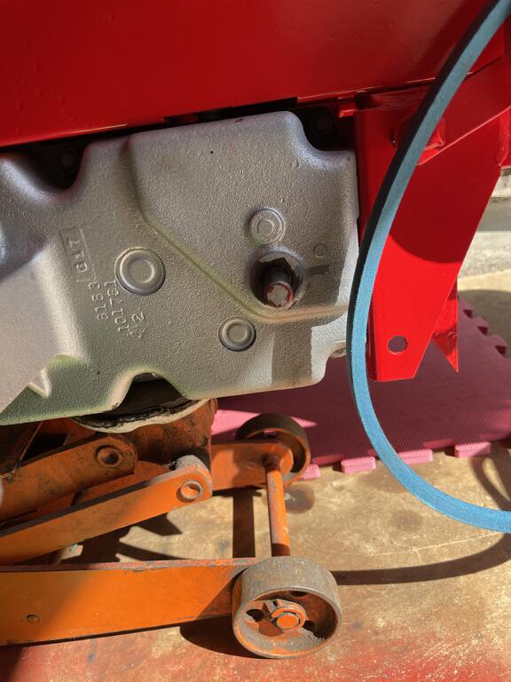

AliT 13 #1 Posted April 4, 2021 Hi there please can someone let me know if I have to take the transmission apart to change the seal in the attached photo. Thank you Ali Share this post Link to post Share on other sites
Jeff-C175 7,206 #2 Posted April 4, 2021 While some might know by looking, I don't. What is it? Can you see the seal from the outside? Share this post Link to post Share on other sites
Bill D 2,246 #3 Posted April 4, 2021 It is not necessary to take the transmission apart to change that seal. You should be able to removed it from the input shaft with a small screwdriver. Check out the pinned thread at the top of the transmission section to find the proper SKF seal number. Bill 2 1 Share this post Link to post Share on other sites
gwest_ca-(File Mod) 11,461 #4 Posted April 4, 2021 The seals are only 1/8" deep so don't drive the screwdriver in too far or you will hit the bearing. I use a scratch awl and since they are so shallow it does not take much to pop them out. Garry 3 1 Share this post Link to post Share on other sites
peter lena 9,251 #5 Posted April 4, 2021 while I agree with gwest above , have used packing pullers for years to repack tank drives , https://www.google.com/search?sxsrf=ALeKk02CROtg-JMarTRSshEDBHaHYdytVQ:1617549965845&source=univ&tbm=isch&q=packing+puller&sa=X&ved=2ahUKEwjE_vqY8-TvAhWuGFkFHXt3B5UQjJkEegQIFBAB&biw=1024&bih=625 , drill a tiny hole , screw it in and pop it out , pete 1 1 Share this post Link to post Share on other sites

The Tuul Crib 7,339 #7 Posted April 5, 2021 Use a small ice pic type tool and just be careful not to go too deep with it because there is a needle bearing behind it and it can be damaged. Putting it back on clean the shaft thoroughly put a little masking tape over the keyway and some Vaseline on the seal and shaft. Tap it in gently with a socket that fits over the shaft that is slightly smaller than the seal. 1 Share this post Link to post Share on other sites
