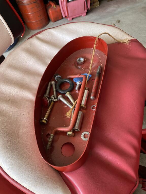

Lane Ranger 11,784 #1 Posted April 2, 2021 Going to make some RJ belt guard spacers today! 1/4 x 1 7/16 1092 hex head cap screw 5/16-18 x 1-3/4" 1196 external tooth shake-proof washer 5/16" 3575 spacer 1/4" x 1-7/16" - If this is Schedule 40 pipe it has an OD of .540" and an ID of .364" 1 2 Share this post Link to post Share on other sites
953 nut 64,101 #2 Posted April 2, 2021 So your RJ belt guard is going to have an eyebolt, heavy duty lag-bolt hanger and a red reflector? 1 1 Share this post Link to post Share on other sites
Lane Ranger 11,784 #3 Posted April 2, 2021 Storage where you can get it! Wheel Horse parts everywhere! 1 Share this post Link to post Share on other sites
