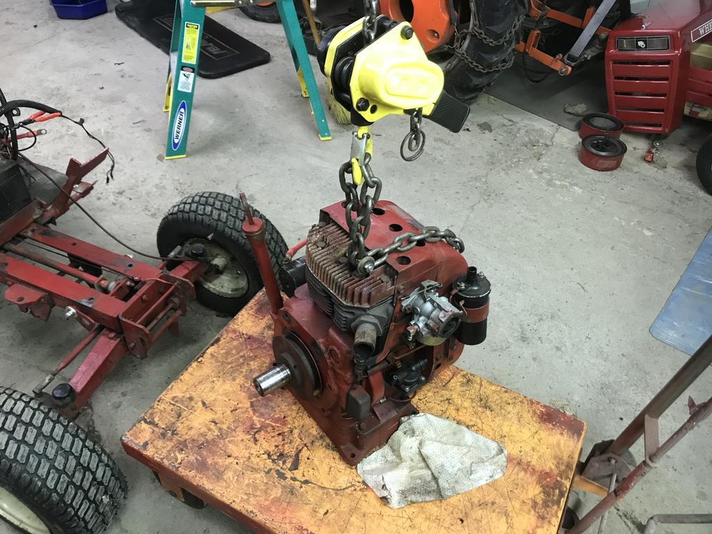

squonk 47,900 #26 Posted April 2, 2021 8 minutes ago, WHX24 said: Some one swapped the head out. It should have what we call a high boss head meaning where the head bolts are then even with the top of the fins. So the head tin goes like this. Last pics is a low boss head with all sorts of PO goofyness goin on. That's a 16 with a starter Jim. It should have this tin: 3 Share this post Link to post Share on other sites
WHX?? 57,821 #27 Posted April 2, 2021 Yah ... all have is mid sixties motors so they must be different. Thought even the parts thumper motor doesn't have the socket holes in the tin will have to look. It's not a WH spec motor either tho. Yes you should have the "half" tin in Mikes' picture then and your head may indeed be correct. 2 Share this post Link to post Share on other sites
