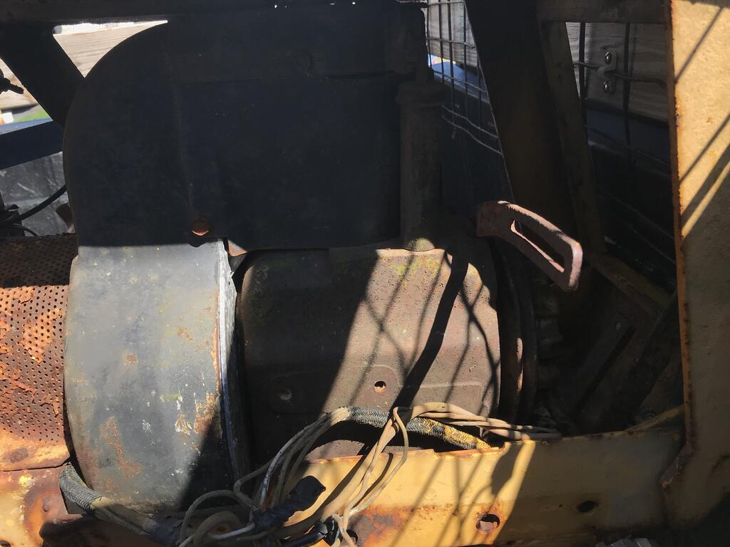

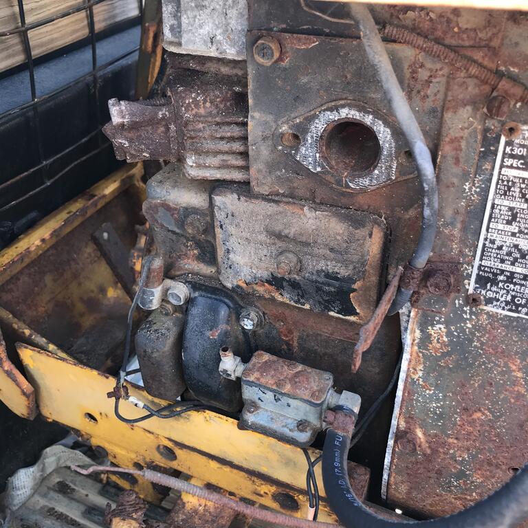

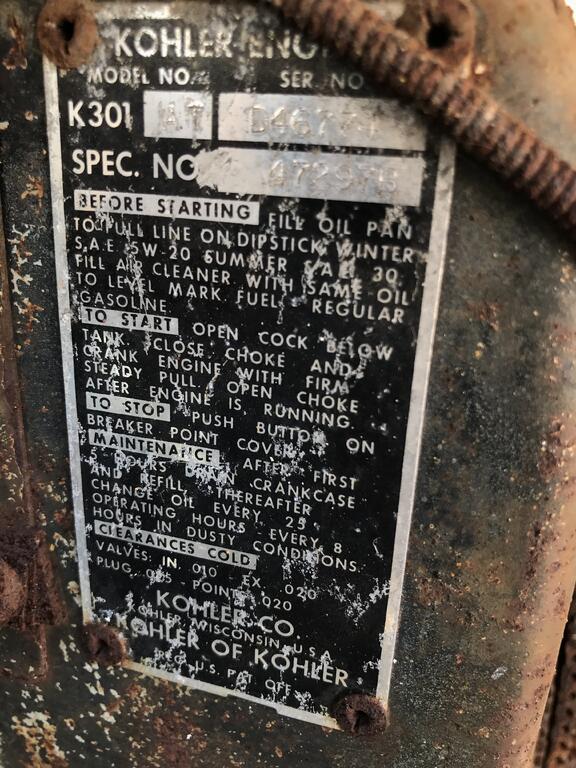

12 hp Kohler 1,020 #1 Posted March 30, 2021 Picked up a Cub 124 puller project yesterday. Upon further investigation of the engine I noticed it came factory with no governor. It’s a kohler k301AT, I’m guessing there pretty uncommon as I have never seen one before. Belive it’s out of an arctic cat snowmobile. Anybody have more information on it ? Does it have stronger internals to run at higher rpm ? Share this post Link to post Share on other sites

gwest_ca-(File Mod) 12,000 #4 Posted March 30, 2021 https://www.partstree.com/models/k301-47297-kohler-k-series-engine-made-for-arctic-enterprises-12hp-9kw/ Garry 1 Share this post Link to post Share on other sites

pfrederi 19,894 #6 Posted March 30, 2021 They did leave out balance gears but rod and piston are the same as all other K301. No air cleaner just a shield to keep big chunks out... 1 Share this post Link to post Share on other sites
