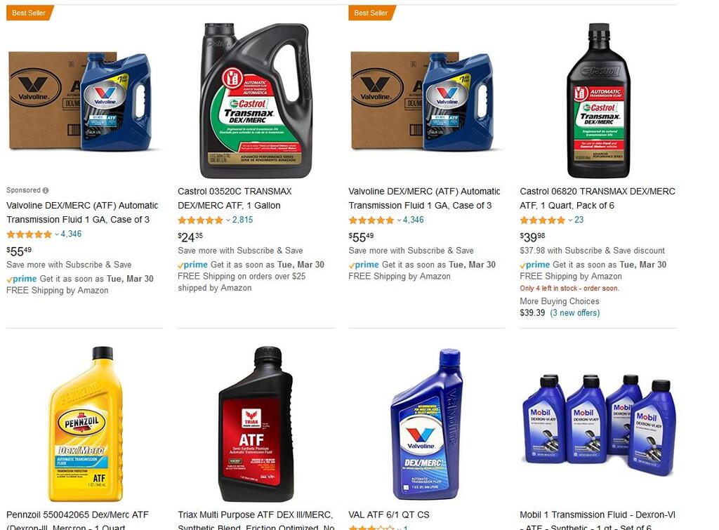

iam206 81 #9 Posted March 28, 2021 On 3/26/2021 at 4:44 AM, ebinmaine said: If you have a Napa nearby it's 75-200 fluid IIFFF it's still red. That's old type ATF. Filter is a Napa 1410 or Wix 51410. Same filter. Avoid fram. Is dexron lll an option to use? 1 Share this post Link to post Share on other sites
pfrederi 19,868 #10 Posted March 28, 2021 Dexron 3 if you can find it is fine so is Dex/Merc widely available from several brands. 2 1 Share this post Link to post Share on other sites
