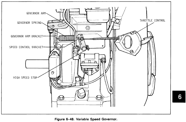

Evel jr 0 #1 Posted March 25, 2021 IWas wondering if anybody can help me With the governor linkage on my 310-8 Not sure what holes the spring goes into Share this post Link to post Share on other sites

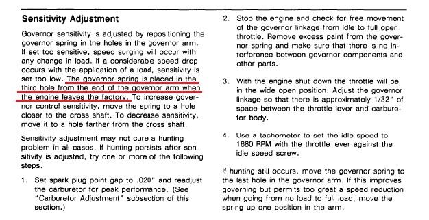

gwest_ca-(File Mod) 11,997 #2 Posted March 26, 2021 5 year old welcome to the forum. Here is the service manual and a pic of where the spring was located when it left the factory. The governor sensitivity can be changed by using the different holes in the governor arm. It is explained in the service manual Garry 1 Share this post Link to post Share on other sites
