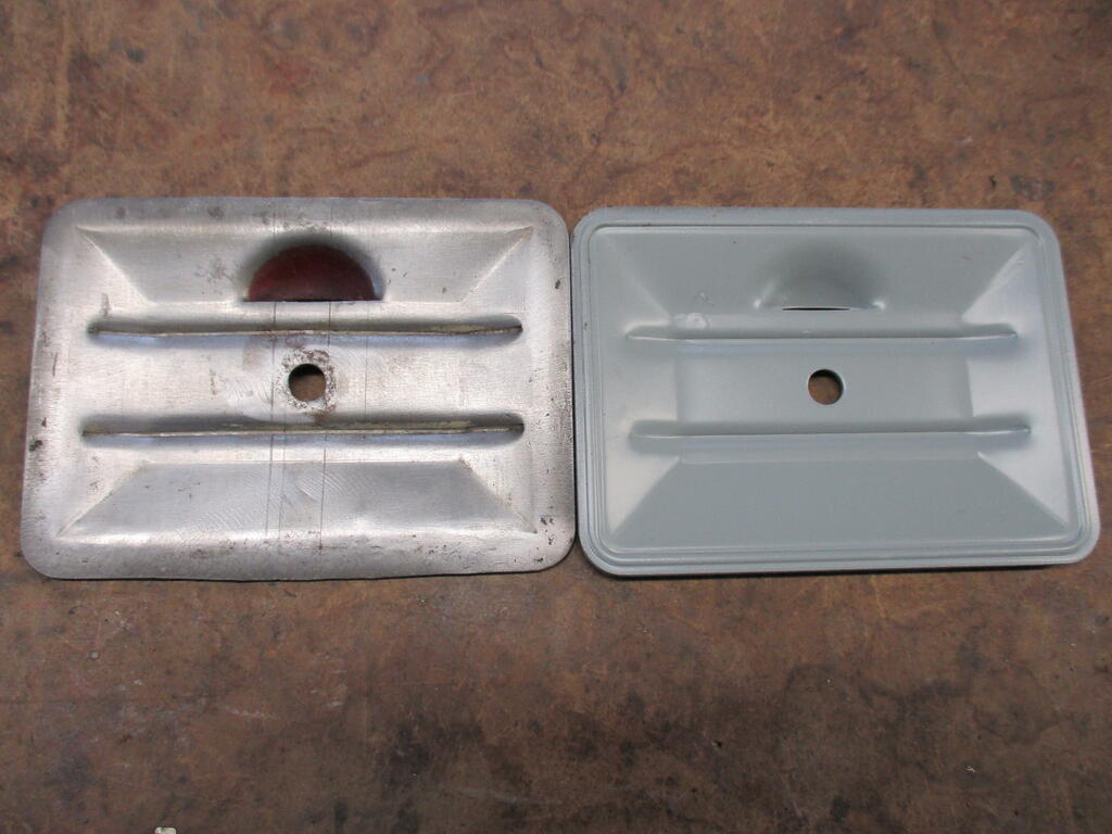

pfrederi 19,894 #1 Posted March 24, 2021 Even correctly installed I have had several Kohlers that weep oil from the valve cover. I hate using sealant as it makes disassembly for cleaning very difficult. I recently made a discovery that Kohler must have noted the problem and changed very slightly the design of the cover. I have put a new version on with no sealant and so far after a few hours no seepage. The little ridge around the cover on the sealing surface bites into the gasket and also may provide a bit more resistance to bending, New on the right. 8 1 4 Share this post Link to post Share on other sites
Handy Don 15,950 #2 Posted March 24, 2021 7 minutes ago, pfrederi said: Even correctly installed I have had several Kohlers that weep oil from the valve cover. I hate using sealant as it makes disassembly for cleaning very difficult. I recently made a discovery that Kohler must have noted the problem and changed very slightly the design of the cover. I have put a new version on with no sealant and so far after a few hours no seepage. The little ridge around the cover on the sealing surface bites into the gasket and also may provide a bit more resistance to bending, New on the right. Engineers, those wily wascals. 1 2 Share this post Link to post Share on other sites

Stepney 2,357 #4 Posted March 24, 2021 Funny that, I've always just run a sharp file along each edge a time or two, old Mercedes diesel mechanic showed that and it works on just about everything. Never seen that part though, wonder when it changed? 1 Share this post Link to post Share on other sites
pfrederi 19,894 #5 Posted March 24, 2021 (edited) 2 hours ago, ebinmaine said: How does one go about procuring a new version? Order one I am assuming new in this case is several years ago... Edited March 24, 2021 by pfrederi 1 Share this post Link to post Share on other sites

Pullstart 68,883 #8 Posted March 25, 2021 3 hours ago, Stepney said: Funny that, I've always just run a sharp file along each edge a time or two, old Mercedes diesel mechanic showed that and it works on just about everything. Never seen that part though, wonder when it changed? create an edge towards the inside, great idea! I just opened a package today and caught an un-deburred edge on my finger... filleted it right open! 2 Share this post Link to post Share on other sites
Stepney 2,357 #9 Posted March 25, 2021 3 minutes ago, pullstart said: create an edge towards the inside, great idea! I just opened a package today and caught an un-deburred edge on my finger... filleted it right open! I'm a machinist so I'm always terribly nervous of burrs of any sort.. Not terribly fun when you notice there seems to be just one corner of your finger tip actually attached.. 2 1 Share this post Link to post Share on other sites

Stepney 2,357 #12 Posted March 25, 2021 20 minutes ago, Jeff-C175 said: I sometimes don't even notice that I've been 'vented' until I see blood smears on what I'm working on. Indeed.. I got a pretty good snag once grabbing a napkin off the floor.. Huh, well the thing was dry a second ago, how'd it .. uh oh. Hey, boss! You got a roll of tape and a good clean cloth?? Haha.. ouch. Just about stripped right hand little finger. On the topic though. Good friend used to rebuild and service Merc diesels. The large truck sort, not the passenger cars. Apparently an old cure-all for random blown head gaskets was to simply drag a file along the affected area. Funny, of all the other old machines I dealt with and all the farmer repairs, I've not heard that one again before or since. 2 Share this post Link to post Share on other sites
