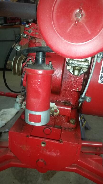

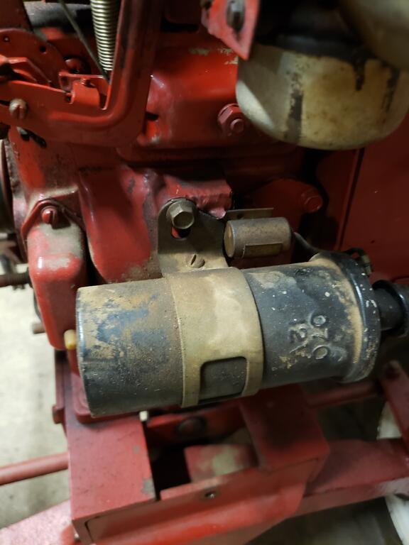

WHX?? 58,068 #30 Posted March 24, 2021 8 hours ago, rustyspace said: Does the Tecumseh use the same starter generator? No Ig coil should be mounted like this Share this post Link to post Share on other sites

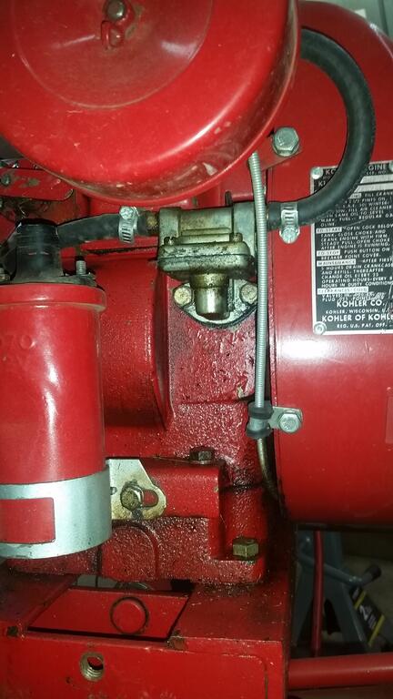

buckrancher 2,697 #32 Posted March 24, 2021 (edited) A 753 with alterations the air filter being mounted up like that is because its the wrong one the 753 uses a thin air filter they have thick one from a 854 and the thicker one will not mount the normal way as the 753 hood is shorter than a 854 hood also there should be a heavy duty push button in the hole above the key switch Edited March 24, 2021 by buckrancher 1 Share this post Link to post Share on other sites

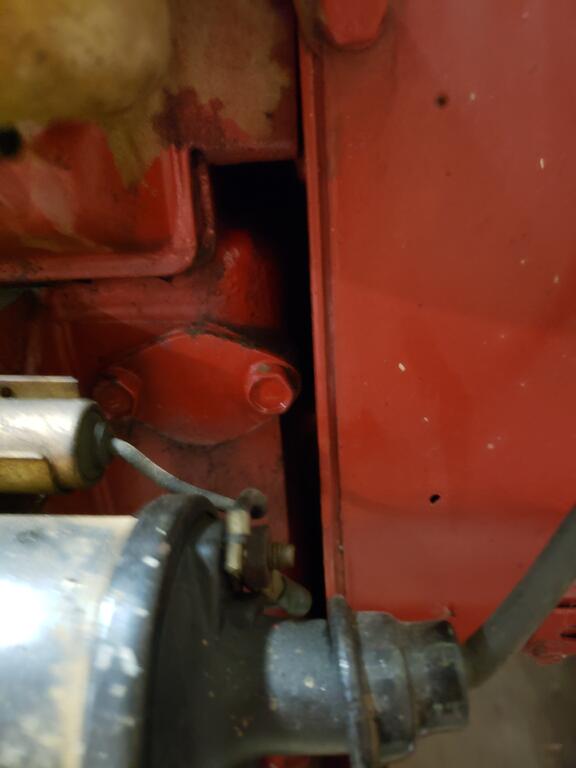

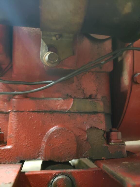

rustyspace 10 #33 Posted March 24, 2021 Here is a better view of the coil mounting bosses cast into the block. Also the fuel pump block off plate. Share this post Link to post Share on other sites
