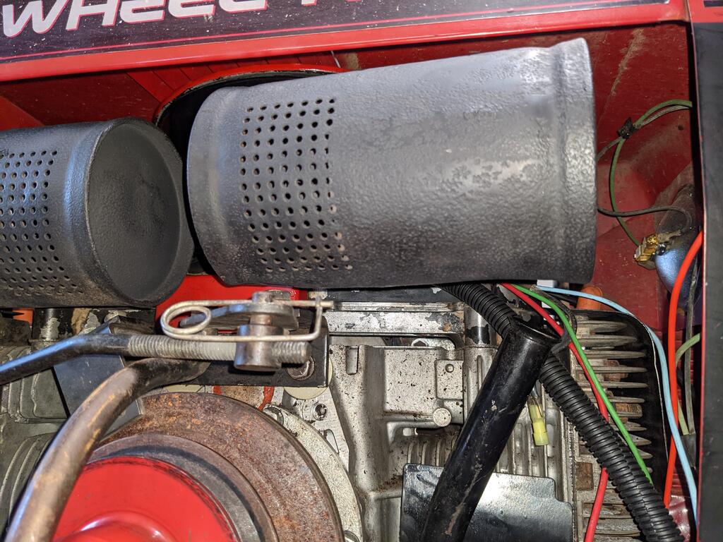

seuadr 490 #76 Posted April 3, 2021 Hood clearance might be tight.. 1 Share this post Link to post Share on other sites

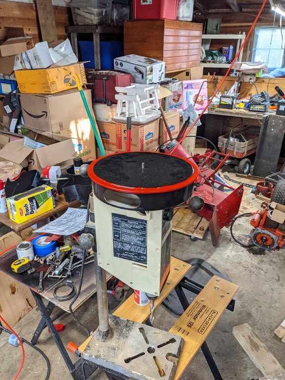

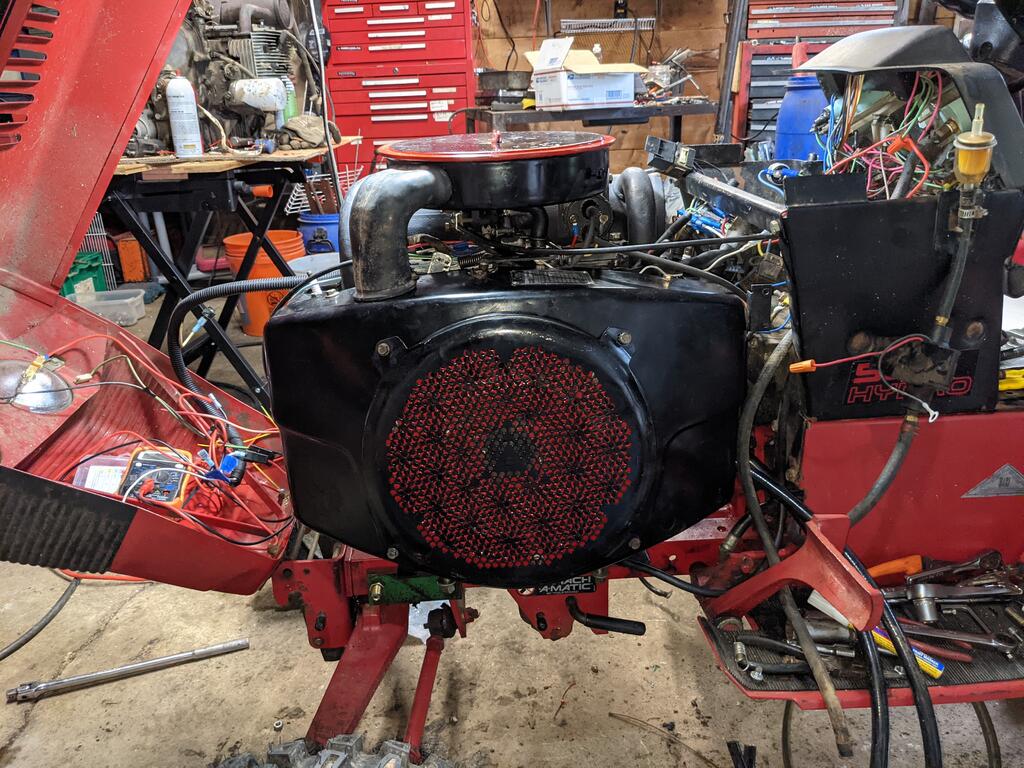

seuadr 490 #78 Posted April 4, 2021 Decided to add a pop of color to the air cleaner housing. 2 Share this post Link to post Share on other sites

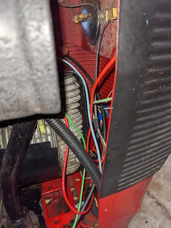

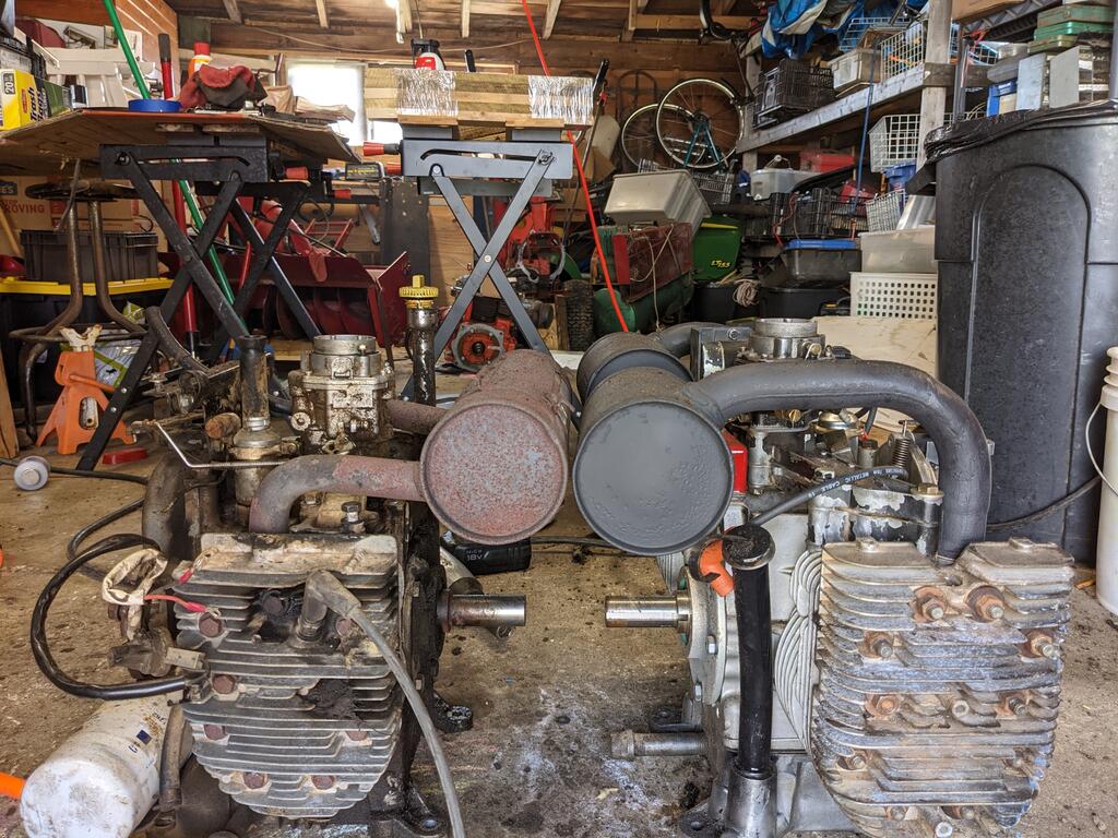

seuadr 490 #79 Posted April 4, 2021 So i installed the foot control kit: But it fits! Even lined up with the existing holes! Muffler clearance is snug Tins mostly fitted in place PTO sits at the same spacing/height Working out the wiring, routing and hooking up, etc. Share this post Link to post Share on other sites

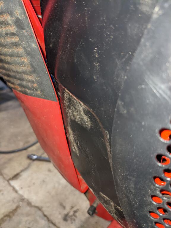

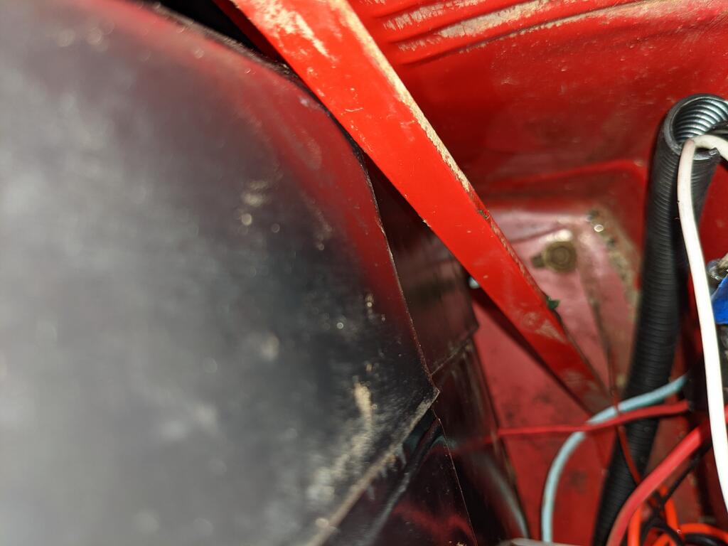

seuadr 490 #80 Posted April 10, 2021 All back together, except yhe remote filter mount (probably going somewhere under the frame like on the snow chucker) Definitely snug! Think I may need to slide the hood forward a half inch or so ultimately. Share this post Link to post Share on other sites

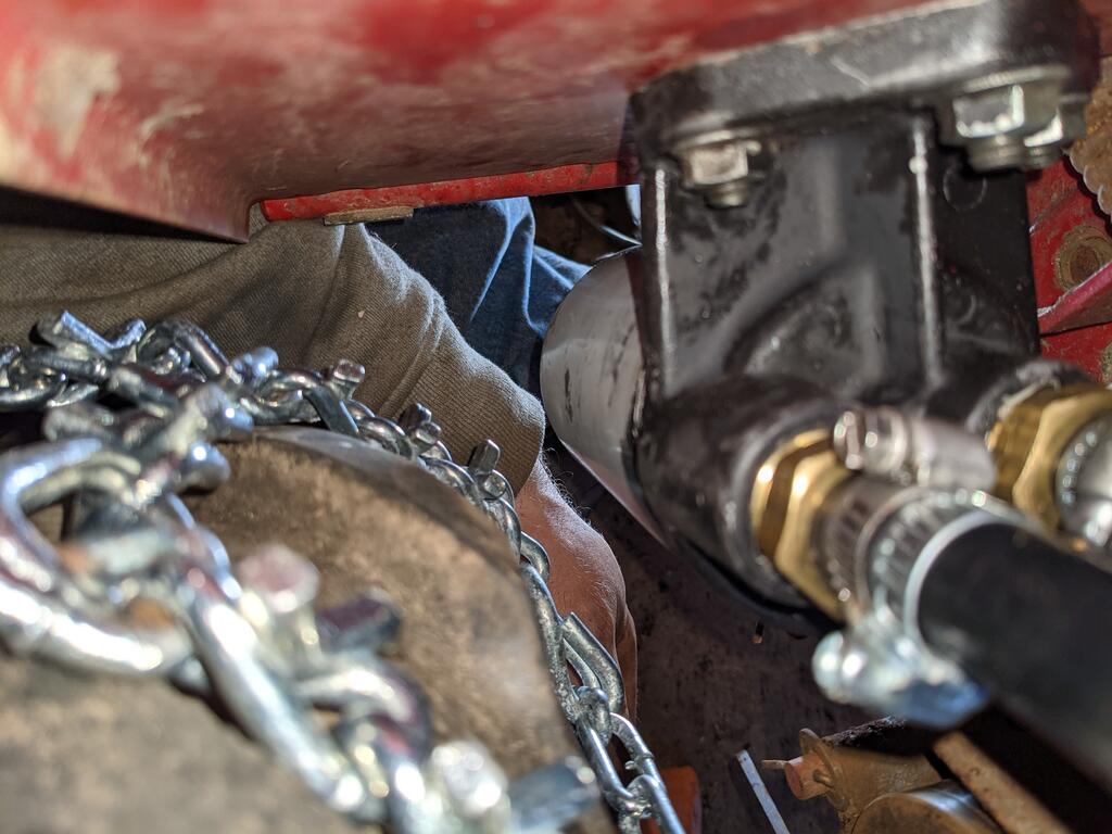

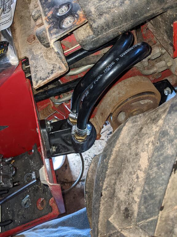

seuadr 490 #81 Posted April 11, 2021 Finally settled on a location for the remote filter: If i measured correctly i should clear my winter chains by an inch: If they don't there is enough room for me to fashion a guard. In fact, i may do that anyhow - i kind of like that idea. Share this post Link to post Share on other sites

Handy Don 17,316 #84 Posted April 11, 2021 21 hours ago, seuadr said: I agree on the snug fit! Red on the inner flywheel screen is a cool idea. May copy that next time I open up my P218! Isn't that the oil dipstick/fill tube hiding under the front-side muffler? Guess you will be waiting for a cool tractor before checking the oil (or wearing welding gloves)! Share this post Link to post Share on other sites
seuadr 490 #85 Posted April 11, 2021 1 hour ago, Handy Don said: I agree on the snug fit! Red on the inner flywheel screen is a cool idea. May copy that next time I open up my P218! Isn't that the oil dipstick/fill tube hiding under the front-side muffler? Guess you will be waiting for a cool tractor before checking the oil (or wearing welding gloves)! yeah, it is :/ i had to orient it that way as the starter is on the opposite corner. seems kind of odd, but, at least with the pressure cutoff switch i know i won't run it out of oil i guess? on the bright side, the oil safety works the way i'd hoped it would - even with the start/kill circuit bypassed by powering straight to the coil, there was no spark at the points for several turns of the motor. 1 Share this post Link to post Share on other sites
