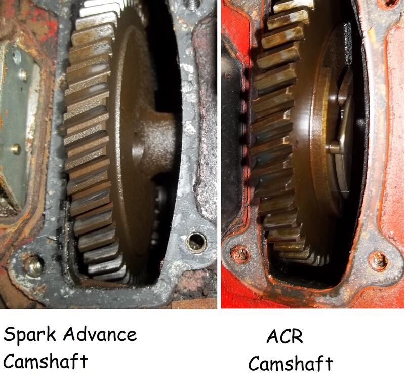

953 nut 70,354 #35 Posted March 17, 2021 (edited) 23 hours ago, WVHillbilly520H said: I believe all Kohlers K/M series are "static" timed even with change in point gap on the Ks you really aren't changing the timing like in car with a distributor , where as the M has the magneto/coil on the flywheel. Someone else can answer that better than myself. Magnum timing is fixed but any K series with battery ignition or points/magneto ignition must be timed by adjusting the points gap. The newer K series with the ACR cam can be static timed but the older models with spark advance cams can only be correctly timed with a timing light. Ignition timing on Kohler engines. Gapping the ignition points at .020 has always been the standard answer to how points should be set. That probably will get you into the ballpark where the engine will run, but with a bit of additional effort you can improve the engine’s power and performance. The Kohler engine manual in the Red Square files section covers two methods for setting the ignition timing, Static Timing and using a Timing Light. This manual is a relatively new manual and it overlooks the fact that many of our engines were built prior to the ACR (automatic compression release) camshaft. Earlier engines (mostly 1965 and earlier) had a Spark Advance camshaft that can not be timed using Static timing. At rest (and very low RPMs) the timing is retarded to fire slightly after TDC. The timing mark (SP) on your flywheel is at twenty degrees before top dead center but at rest the points on these engines break about ten degrees after top dead center. The only reliable way to check or set the timing on these engines is with a timing light. There are a couple ways to determine what camshaft you have. Presuming the camshaft in your engine is the one it was born with the data plate on the engine has a suffix that can tell you what camshaft was used. The table below will tell you the suffix applicable to your engine. The other way to determine what camshaft you have is to remove the cam gear cover and take a look. If you see a mechanism attached to the cam gear it is the ACR cam. The following engines have the spark advance camshaft; K-141, Suffix prior to “C” K-161, Suffix prior to “J” K-181, Suffix prior to “D” K-241, Suffix prior to “D” Edited March 17, 2021 by 953 nut 2 1 Share this post Link to post Share on other sites

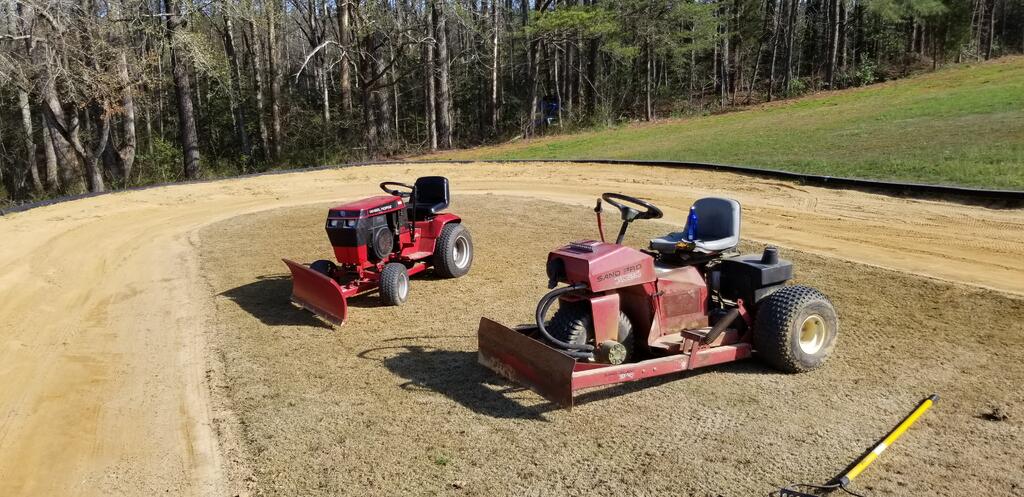

racerjohnbf 130 #38 Posted April 7, 2021 Well today I got the oil changed and greased her up and put the horse to work for a little while. I'm impressed, although I did find I'll need a new drive belt cause it will slip before the tires lose traction. And although the snow/dozer blade did a good job, I will be building an mid mount grader blade in the future, because I think it will work even better. Share this post Link to post Share on other sites
