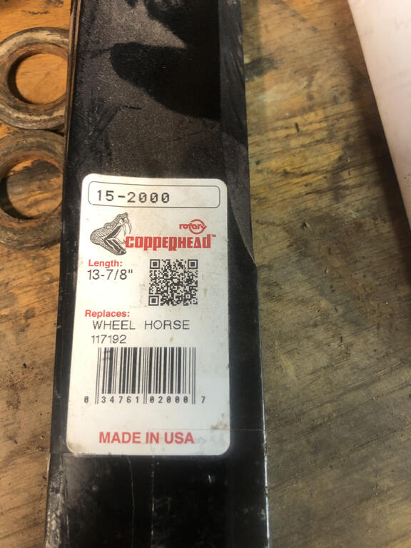

The Tuul Crib 7,347 #1 Posted March 13, 2021 Looking through my parts I run across this set of three blades still in plastic. But I'm not sure what they fit on anybody know by the number? Share this post Link to post Share on other sites
oldlineman 1,656 #2 Posted March 13, 2021 looks like a 42 in deck 1 Share this post Link to post Share on other sites
The Tuul Crib 7,347 #3 Posted March 13, 2021 Well they're a little shorter than what a 42 inch deck calls for. I am looking to order some blades for my 42 inch rear discharge and calls for a 14 1/2 inch blade. these are 13 7/8. Share this post Link to post Share on other sites
gwest_ca-(File Mod) 12,015 #4 Posted March 13, 2021 May not fit them all if any of these models shared a illustrated part list. That is what happened for the 1990 models. 05-38SY01, 38" Side Discharge Mower, 1990 - No fit 05-42RY01, 42" Rear Discharge Mower, 1990 - No fit These used on 612-Z, 616-Z and 620-Z 05-42SY01, 42" Side Discharge Mower, 1990 - Yes fits 05-42SY02, 42" Side Discharge Mower, 1991 (SN 1000001-1999999) - Yes fits 05-42SY03, 42" Side Discharge Mower, 1992 (SN 2000001-2999999) - Yes fits 78415, 42" Side Discharge Mower, 1993 (SN 3900001-3999999) - Yes fits 78415, 42" Side Discharge Mower, 1994 (SN 490001-499999) - Yes fits 78415, 42" Side Discharge Mower, 1995 (SN 590001-599999) - Yes fits 117192 also replaced 116207 but do not know what those fit. Garry Share this post Link to post Share on other sites
The Tuul Crib 7,347 #5 Posted March 13, 2021 46 minutes ago, gwest_ca said: May not fit them all if any of these models shared a illustrated part list. That is what happened for the 1990 models. 05-38SY01, 38" Side Discharge Mower, 1990 - No fit 05-42RY01, 42" Rear Discharge Mower, 1990 - No fit These used on 612-Z, 616-Z and 620-Z 05-42SY01, 42" Side Discharge Mower, 1990 - Yes fits 05-42SY02, 42" Side Discharge Mower, 1991 (SN 1000001-1999999) - Yes fits 05-42SY03, 42" Side Discharge Mower, 1992 (SN 2000001-2999999) - Yes fits 78415, 42" Side Discharge Mower, 1993 (SN 3900001-3999999) - Yes fits 78415, 42" Side Discharge Mower, 1994 (SN 490001-499999) - Yes fits 78415, 42" Side Discharge Mower, 1995 (SN 590001-599999) - Yes fits 117192 also replaced 116207 but do not know what those fit. Garry Thanx Garry!! Share this post Link to post Share on other sites
Lee1977 7,576 #6 Posted March 14, 2021 (edited) I went down and turned my 42" deck over and measures that is what is on it. The blade are worn and measure around 13 3/4". It don't have a tag as the 42 always rust out at the height adjustment. It came with my 1989 520-H has the bar or tube reinforcement around the front. Edited March 14, 2021 by Lee1977 1 Share this post Link to post Share on other sites
oldlineman 1,656 #7 Posted March 14, 2021 Yea sorry I knew 42" side and rear (i have both) required different size blades but didn't know off hand witch way they were. As always Garry came to the rescue! Share this post Link to post Share on other sites
