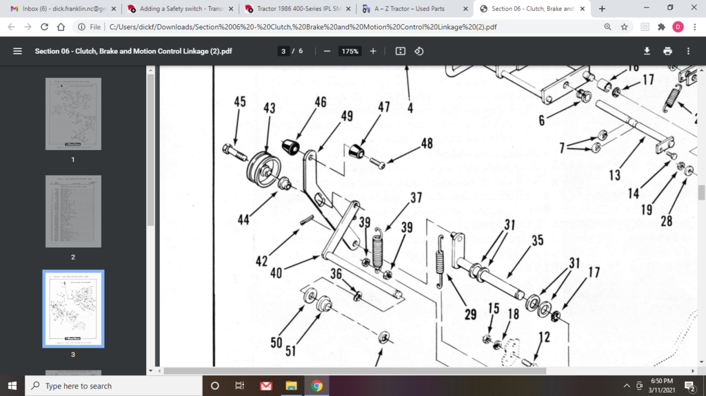

953 nut 59,674 #9 Posted March 13, 2021 The service manual below may be helpful. Be sure the belt tensioner (part 49) is down and the motion control lever is forward when pushing. go very slowly. Share this post Link to post Share on other sites
