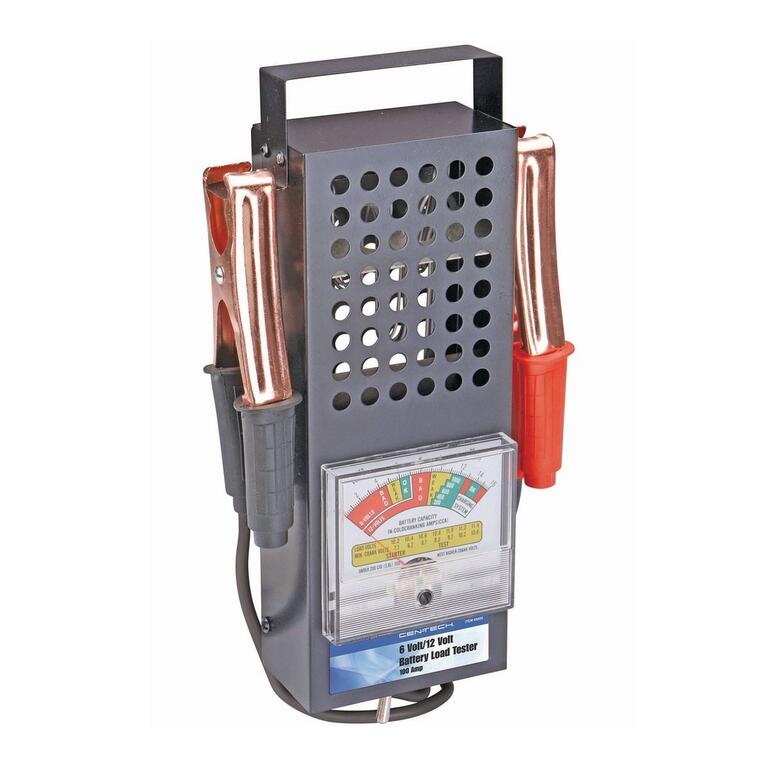

WHX?? 54,327 #9 Posted March 12, 2021 yep the best 20 bucks I have spent at HF. 3 2 Share this post Link to post Share on other sites
