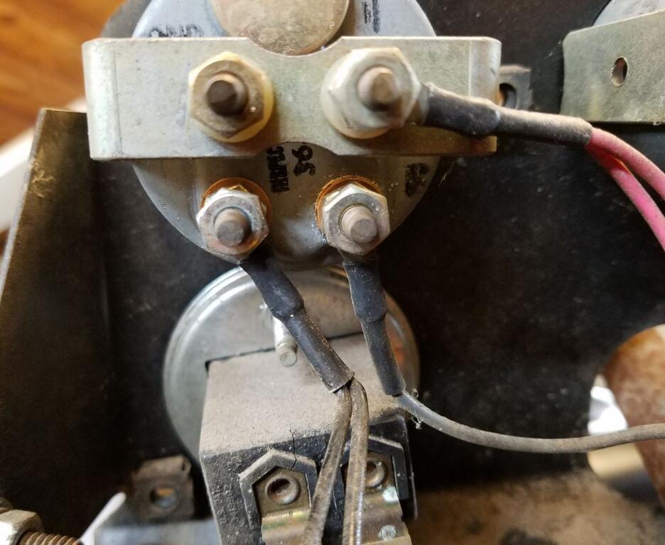

Hello all,
Wheel Horse 1988 520-H model 31-20OE01
 I just received a new Tach ( from a Marine Surplus in the mail today. However There are no instructions with it. There are S G I designations on it .
on the old Tach
Can someone please verify the correct hook up.
Thank you
Handy Don
Sensor, Ignition, Ground.
Sensor is from the stator (sends pulses of electricity to the meter)
Ignition powers the instrument
Ground is, well, ground.
On the original, Pinks are Ignition and blacks are ground and blue is sensor
Hoping the specs are for an engine with the same number of pulses per revolution as you engine (the Onan has 9 pulses per rev).
Handy Don
Looks like there were two grounds on the original. Test with ohmmeter for conductivity between the GND and the terminal below it that had the blacks connected.
acc7484
The ground on the old unit is the upper left terminal...that has no connection.
So it appears there is an internal gnd .
OK ....thank you Don ....
